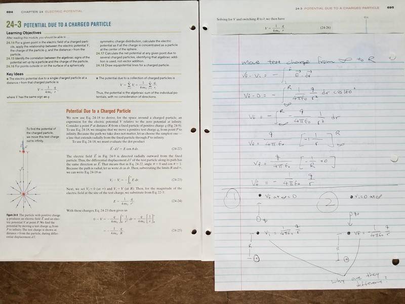

The textbook says to find the electric potential due to a point charge by moving a test charge from R to infinity, and integrating using the equation below. But when I integrate from infinity to R, the sign switches. Why is that? Both times, electric potential at V is 0.
This is confusing because to find the electric potential from point charge, you integrate from R to infinity, but to find the potential energy of a system, you integrate from infinity to R
Rinf E dot ds = Vf - Vi
From R to inf
Vi = K q/r
From inf to R
Vf = -K q/r

Hi ben123467,
:welcome:
You need to be a bit careful when you integrate an expression that comes from vectors. The electric field has a direction, and so do the ds elements. The ds elements have a direction that depends upon your limits of integration. When you exchange the limits, the direction of the ds elements change. In the scalar version of the integration, that's handled by the ##cos(\theta)## in the dot product.

I took into account the opposite directions of E and ds though. I uploaded a picture, can you check my math?
Kind of difficult to read your image due to the scale. A closeup of the textbook page posted separately might help, and either the same for your handwritten work or, much preferred, type out your work so that helpers can easily quote individual lines in their replies. The ##\Sigma## icon in the edit window header bar gives you access to math symbols, and you can also use LaTeX syntax to render math expressions in a very nice way.
There's a link to imgur below the image if that helps. You can zoom in from there.
Still no joy. The zoom is the same as what's available for your in-post image.
