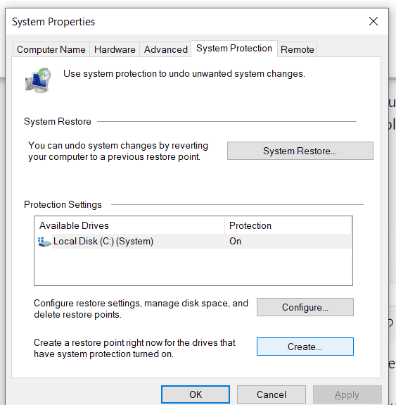

You didn't say for what purpose you might need to edit the registry (there might be another way).
Regarding backing up the registry before editing: rather than trying to manually backup the registry hive files, the simplest and safest way to way to do an effective backup, so that you have the option post-edit to regress the changes you made, is to use System Restore: from the run box or command prompt, enter sysdm.cpl
You get a Systems Properties dialog box like this:
Press the Create button to create a Restore Point for the 'pre-edit system', which can later be used to 'back out' the changes: from the run box or command prompt, enter rstrui.exe
Likes WWGD, russ_watters and Borg
Don't you need to start Windows to use System Restore to recover a Restore Point?
If not, please enlighten us by describing the procedure.
Cheers,
Tom
If a registry-edit-engendered error is preventing Windows from starting normally, then booting into 'Safe Mode' should be tried. On most PCs, hitting F8 repeatedly about once per second during bootup will get you to a startup menu that includes Safe Mode as an option, but the exact procedure can vary. Safe Mode doesn't load the entire system, and usually can start even if a registry error is preventing normal startup. If you can't get into normal Safe Mode, you can try Safe Mode with Command Prompt, at which point you can exercise command-based options such as copying and renaming registry hive files.

sysprog1 said:
I've used Revo Uninstaller (there's a free portable version available) with good results -- I note that it always creates a restore point before it does 'anything else that could matter'.
But is the restore point helpful if the change in the registry freezes your PC?
Yes. Each 'restore point' associates with a specific backup copy of the registry hive files. If your pc is not startable from the device containing the befouled registry -- not even in 'Safe mode with Command Prompt', then you can boot from a different device, e.g. a flash drive, and then do renames on the hive files to effectively restore from the backup versions.
