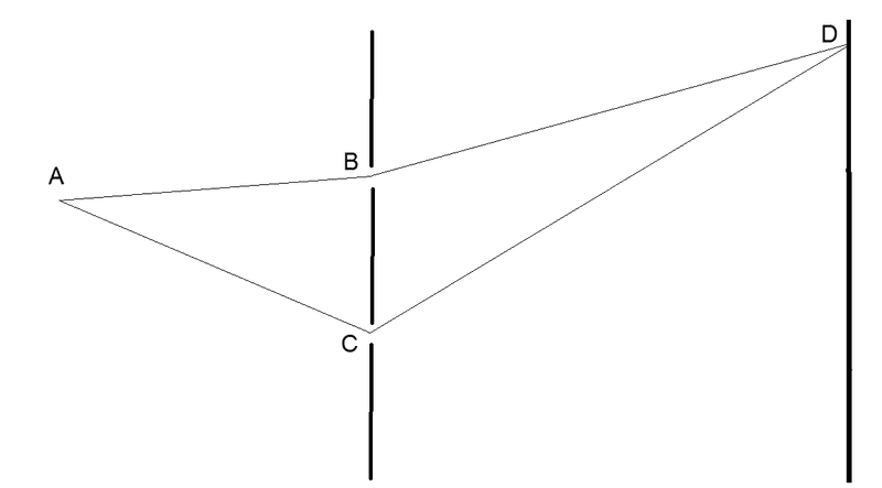

Here are the rules for computing probabilities in quantum mechanics. If you have an initial state [itex]|I\rangle[/itex] and a final state [itex]|F \rangle[/itex], then you compute the probability amplitude for going from state [itex]|I\rangle[/itex] to state [itex]|F\rangle[/itex] using the Hamiltonian. You get a complex number [itex]T_{IF}[/itex]. The probability of going from state [itex]|I\rangle[/itex] to [itex]|F\rangle[/itex] is then [itex]P_{IF} = |T_{IF}|^2[/itex], which is always a positive number (or zero).
Now, what about interference? Well, suppose that there are two paths to get from [itex]I[/itex] to [itex]F[/itex]: Via intermediate state [itex]|A\rangle[/itex], or via intermediate state [itex]|B\rangle[/itex]. For example, you send an electron through a screen with two slits, and the electron collides with a photographic plate beyond the screen, creating a black dot. You're trying to figure out the probability of getting a dot at a particular location on the plate. The electron could either go via the first slit, or via the second slit.
The amplitude for getting from the initial state [itex]|I\rangle[/itex] to the final state [itex]|F\rangle[/itex] is just the sum of the amplitudes for all the alternative paths. So in the simple case of two alternative intermediate states, we have:
[itex]T_{IF} = T_{IAF} +T_{IBF}[/itex]
where [itex]T_{IXF}[/itex] is the probability for getting from I to F via intermediate state X.
Then the probability will be:
[itex]P_{IF} = |T_{IF}|^2 = |T_{IAF}|^2 + |T_{IBF}|^2 + 2 Re ((T_{IAF})^* T_{IBF})[/itex]
(This just uses the fact that for two complex numbers A and B, [itex]|A + B|^2 = |A|^2 + |B|^2 + 2 Re(A^* B)[/itex])
If we write [itex]P_{IAF} = |T_{IAF}|^2[/itex] and [itex]P_{IBF} = |T_{IBF}|^2[/itex], then this becomes:
[itex]P_{IF} = P_{IAF} +P_{IBF} + \chi_{AB}[/itex]
where [itex]P_{IAF}[/itex] is the probability of going via intermediate state [itex]A[/itex], and [itex]P_{IBF}[/itex] is the probability of going via intermediate state [itex]B[/itex], and [itex]\chi_{AB}[/itex] is the interference term: [itex]2 Re ((T_{IAF})^* T_{IBF})[/itex], which can be either positive or negative. The probabilities behave like classical probabilities if the interference term is zero (or more generally, is unpredictable so that it averages to zero).
Entanglement destroys this interference term.
Likes Pedro Zanotta, zonde, Simon Phoenix and 1 other person

This is the perfect explanation, thank you. Would it be naive to ask how that interference term is destroyed in a conceptual sense, rather than mathematically?
Well, interference only happens between two different intermediate states that lead to the same final state. So for example, in the two-slit experiment you set things up so that there is a source of electrons (or photons, or whatever), then they have to pass through a screen with two slits, and then finally they smash into a photographic plate beyond the screen, making a black dot. So the final state is smashing into a dot on the plate, and the two intermediate states are the two possible slits the electron can pass through. Interference between these two possibilities leads to the distinctive pattern of spots on the plate. So the initial state [itex]I[/itex] is the creation of the electron on one side of the screen, the intermediate states [itex]A[/itex] and [itex]B[/itex] are the electron passing through one or the other slit, and the final state, [itex]F[/itex] is the electron making a dot on the plate.
Now, suppose that immediately after the electron passes through one of the slits, we make a measurement as to which slit it went through. I don't know--maybe take a picture of it (that's not really possible, but say that it is). Then in that case, the two alternative paths produce different final states for the combined system of electron + measurement
  1. There is a dot on the screen at some location, and there is a record of the electron going through the first slit, A. Call that state [itex]F_A[/itex].
  2. There is a dot on the screen at that location, and there is a record of the electron going through the second slit, B. Call that state [itex]F_B[/itex]
For different final states, you don't add the amplitudes and then square, you first square and add the results. So instead of:
[itex]P_{IF} = |T_{IAF} + T_{IBF}|^2[/itex]
you get:
[itex]P_{IF} = |T_{IAF_A}|^2 + |T_{IBF_B}|^2[/itex]
The interference term is lost, because there is only interference between paths with the exact same final state.
Decoherence is like a measurement, in the sense that the particle interacts with the environment in a way that makes a permanent change to the environment. Maybe the pattern of photons radiated away from the electron. So a different path leads to different final states of the environment (even though, unlike a real measurement, you can't actually compute which path the electron took based on the patterns in the environment) and so there is no interference between the two alternatives.

I´m not a physics, but like the subject, a lot. Sorry if my question is too naive. But that is the point: the recording on the photographic plate is not doing this measurement? I mean, if the plate is posicioned more close to the slits, it can´t do the job? Why something that take a picture of the electorn works, but something that effectivelly do this (the plate) don´t work? Or, in other words, why the system divised to register the passage of the electons by the slits (A or B) does not register the simultaneous passage of the electron for both slits (as the plate does)? Is it clear? Thanks for answering. (And sorrow for my english.)
[]s
Pedro
If you're talking about the two-slit experiment, the point is that there are two ways that the electron can get to the plate: it can go through the first slit, or it can go through the second slit. So the dark spot on the photographic is not a measurement of which slit the particle went through, it is a measurement of where the particle ended up. Mathematically, a measurement of an intermediate state destroys interference between alternatives, which in turn changes the probabilities for final states.
Likes Pedro Zanotta
