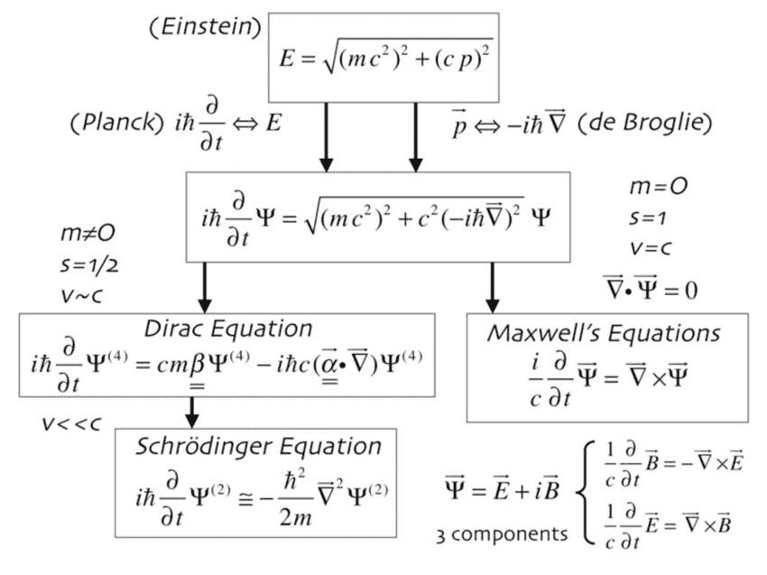

Michael Raymer uploaded this paper, which he co-authored: https://www.researchgate.net/profile/Michael_Raymer/publication/260262749_The_Maxwell_wave_function_of_the_photon_Invited_Paper/links/0fcfd511571719af6d000000/The-Maxwell-wave-function-of-the-photon-Invited-Paper.pdf (available for pdf download here: https://www.researchgate.net/publication/260262749_The_Maxwell_wave_function_of_the_photon_Invited_Paper)
and which contains this illustration:
Fig. 1 Flow chart for derivations of electron and photon wave equations, m = rest mass, s = spin, v = velocity.
Likes Demystifier, DrChinese and fresh_42
Well, are the problems with the "non-local" operator in the 2nd box discussed in this paper? I don't click on research gate links anymore.
Didn't find this mentioned anywhere when I read it.

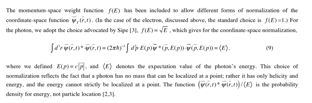

I guess I'm not as 'seasoned' as you are in that regard ##-## the paper doesn't discuss 'Schrödinger steering', but it does make brief reference to the fact that the photon doesn't exhibit the locality that is characterizable with Schrödinger's ('(##v<<c##)-bounded' approximation) equation.
Just after Fig. 1 the paper says this:
In modern terms, a photon is an elementary excitation of the quantized electromagnetic field. If it is known a priori that only one such excitation exists, it can be treated as a (quasi-) particle, roughly analogous to an electron. It has unique properties, arising from its zero rest mass and its spin-one nature. In particular, there is no position operator for a photon, leading some to conclude that there can be no properly defined wave function, in the Schroedinger sense, which allows localizing the particle to a point. On the other hand, it is known that even electrons, when relativistic, don’t have properly defined wave functions in the Schroedinger sense [2,3], and this opens our minds to broader definitions of wave functions. In relativistic quantum theory, one distinguishes between charge-density amplitudes, mass-density amplitudes, and particle-number density amplitudes. These can have different localization properties. Photons, of course, are inherently relativistic, so it is not surprising that we need to be careful about defining their wave functions.​
And later:
So it seems to be a good paper. Is there a link to a respectable source like the arXiv. The problem with research gate is that once I wanted to download a paper, for which I had to register, and after that my e-mail inbox was spammed like hell by all kind of information about papers I didn't want to read ;-)).
