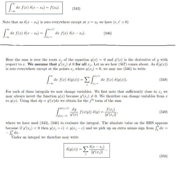

I'm not sure how they got the RHS of equation 349:
where did the |y'(xj)| in the denominator come from?
According to (343) the RHS is only f(x0) which in this case is the jth term of the sum that gives y(xj) = 0..
