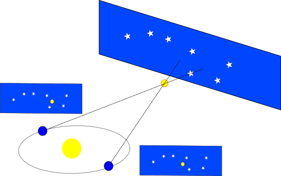

How is that angle measured? How do they know that angle?
How do they know that a parallax angle of one arcsecond is 1 parsec (1 parsec = ~206265 AU)?
And like in this picture:
When what we see is only a star changing its position, how is the parallax angle determined from that observation?
In other words:
How is the "apparent motion of stars" measured in angle degrees?
Basic trig.
You have an isosceles triangle. The Earth is two endpoints and the star in question is the third. You also have measured the angle for the star. Create a right triangle by bisecting the isosceles (basically making the sun one of the endpoints of the triangle.) Then remember SOHCAHTOA? You have the opposite side (93 million miles,) and the angle, so use an inverse sine, and you'll get the distance to the star.
When we look at two photographs and find that one of the stars has moved relative to the background stars we simply measure the distance from the nearest background star whose position hasn't noticeably moved. Note that the sky has been mapped out with a coordinate system for centuries and it is trivial to find the position of a star relative to this celestial coordinate system. Since our coordinate system is in angles, when you measure the distance to the nearest background star on an image you are also measuring the angular distance.

@Drakkith: In the past it has been easy to find the position of a star with respect to these coordinates, but with increasing precision in star measuments it got more difficult. Gaia performs the most accurate measurements ever at the moment, and determining its current orientation is one of the most challenging aspects of the data analysis. The measurements are so precise that the vast majority of sources move within the measurement time and the accuracy of Gaia. It relies mainly on cross-references between its two telescopes. Their relative distance has to be monitored with a precision of the size of an atom.

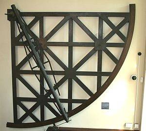

A mural instrument was the classic:
