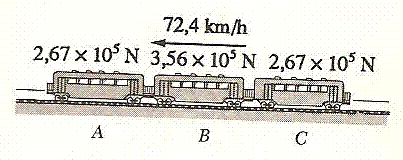

The composition of meters shown in Figure traffic to 72,4 km/h when the brakes of the wheels A and B were activated, causing the derailment. Determine (a) the distance traveled by the rest and (b) the force in each coupling. The coefficient of kinetic friction between the wheels and rails is 0,30.
Answer:
(a) 98,1 m
(b) FAB = 2,4x10^4 N; FBC = 5,6x10^4 N
My solution:
(a) Kinetic energy:
T = 1/2mv^2 = 1,83x10^7 J
Work:
U = (PT - FT).x
PT (Total weight) = 89x10^4
FT (Total force of friction) = 2,67x10^5
U = 6,23x10^5x
x = T / U = 29,44m Is not the correct answer
Apprentice123 said:
My solution:
(a) Kinetic energy:
OK.
Work:
U = (PT - FT).x
I don't understand this equation. You just need the work done by friction.
Only two of the three cars produce friction.
Doc Al said:
OK.
Yes. Thanks
U = 1,87x10^5
x = T/U = 97,86m
How do I calculate (b)?
Consider each car separately. Apply Newton's 2nd law. (What's the acceleration of each car?)
Acceleration is the same for all cars?
V^2 = (Vo)^2 +2aX
a = V^2/2X = 2,066 m/s^2
I not find the correct answer
FAB = FatA + FatB + (mA+mB)a
FatA = PA . u
FatB = PB . u
FAB = 3,18x10^5 N
V^2 = (Vo)^2 +2aX
Looks OK.
I don't understand what you are doing. Analyze each car separately.
For example, consider car A. What horizontal forces act on it? (One force is the coupling force FB/A from car B.) Apply Newton's 2nd law to solve for that force.
Doc Al said:
Looks OK.
Yes. But I do not find the answer
Fb/a = (2,67x10^5)/9,81 * 2,066 + 2,67x10^5 * 0,3
Fb/a = 136330,581 N
Fb/a = 136330,581 N
ΣF = Ff + Fb/a = m*a
Ok. Thank you very much
