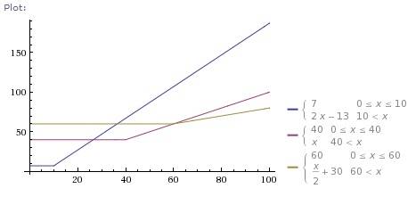

A popular program online for plotting functions is Wolfram|Alpha: Computational Knowledge Engine.
Entering this command there:
piecewise[{{7,0<=x<=10},{2x-13,10<x}}],piecewise[{{40,0<=x<=40},{x,40<x}}],piecewise[{{60,0<=x<=60},{x/2+30,60<x}}] where x=0 to 100
produces this graph:
This will give you an idea where to look for the intersection points. To find them, set the two functions equal to one another (using the appropriate piece), and then solve for $x$, then use this value of $x$ in either function to find the value of $y$.

If you notice from the graph, the Appetizer line intersects the other piece of the Voyager line, i.e., the horizontal part.
so how would i get that?
Equate the non-horizontal portion of Appetizer to the horizontal portion of Voyager.

Using the graph as a guide, we can see that it is the non-horizontal portion of Appetizer that intersects with the horizontal portion of Voyager. So, you already know the $y$-coordinate of this point, you simply need to solve the resulting equation for $x$ to get that coordinate.

ohhh ok.
I appreciate all of the help I am getting, thanks guys. I am actually done with this topic, i just want to know everything exactly how it is.
Thank you! How would i put that into wolfram for the graph?
and how would i do it without the included gigabytes, and the graph for that one?
