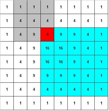

This is the only way (in two dimensions) I can think of it, since the question confuses me, too.

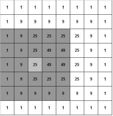

So the difference to my interpretation is, that I required an expansion in all directions, and the book only in one direction, the shortest to the outer boundary.
How did you get all those perfect squares of odd numbers?
Can you please explain your 2D structure?
What do you mean by
Then let me choose the version where expansion isn't required to be in all directions.
Here the square (3,4) has a distance of 3 squares to hit the boundary first, here to the top. So a minimum of ##3^2=9## grey squares can be covered without leaving the outer square. The blue one is bigger (25), but as far as I understood it, the smallest one is meant.

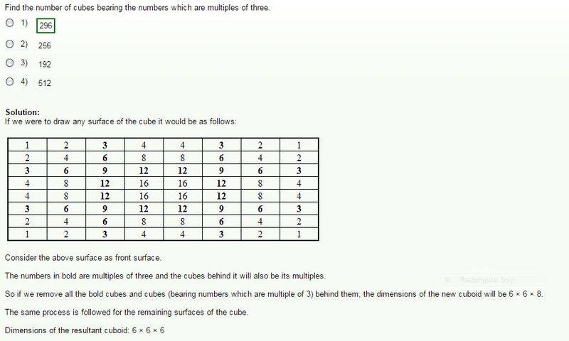

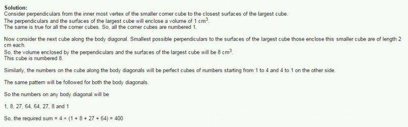

By the way , Attached is the given solution which I did not understand.
Can you please tell if it makes any sense?

I fold. I have no idea, how the numbering is actually meant to be. I thought I had, but this solutions looks quite different to what I have thought.
