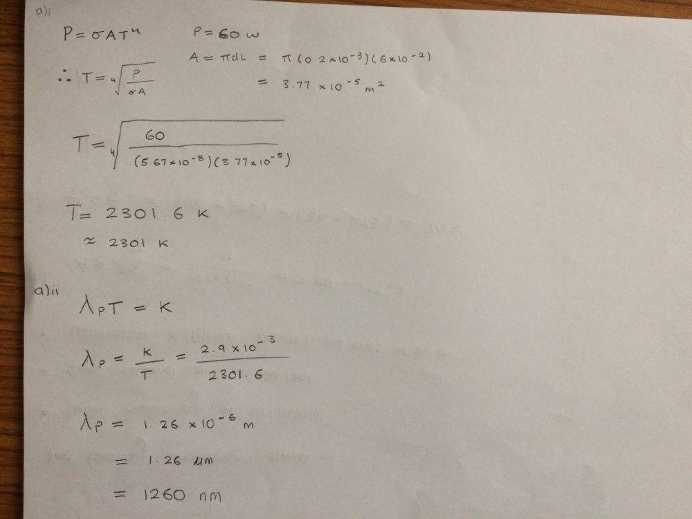

Can anyone please guide me in what I'm missing to answer part b)i?
I can't seem to work out the thermal conductivity (k) in order to find the heat transfer by conduction? Or is the different approach that I must take to do this question?
Thanks for any help!
