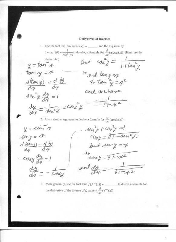

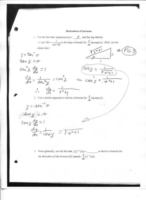

I need to calculate the expression for the derivative of the inverse tan and sin. I have written my solution of the inverse tan on the attachment but I have questions. Also, using the same method, the calculation of the derivative of the inverse sin does not work.
y = tan^-1(x) find dy/dx and y = sin^-1(x) find dy/dx
I calculated an expression for the derivative of the inverse tan but I did not use the identity as suggested. Why did I need to use this identity. Did I do the problem correctly? I got the correct answer.
I tried to do the derivative of the inverse sin the same way. I used the same figure 1 on the diagram that I used for the tan problem. However, my answer, sqrt(x^2 + 1) is not correct, The correct answer, according to the book is 1/sqrt(1-x^2).
I cannot see the error.

Using the picture method for sin one would draw a triangle with hypotenuse =1
I agree hutch but is there some reason I could not use the fig 1 diagram?
The sin of y is not x. It is x/ hypotenuse. You need to use it correctly!
Agreed, but I would think that since both diagrams are correct in a Pythagorean sense that using a change of variable or other trick might make the first figure work. I guess not. I have the correct answer now I will just have ot clear my head. Thanks
If you do it correctly it will work perfectly. If you write down an equation that is incorrect you will get wrong anwers. From your picture, write down sin (y). Proceed. It will be messy.
For one,d/dx(sinx)=cosx, not -cosx. And when setting y=tan−1(x)y=tan−1(x) you do not get d(y)/dx=1. Nice try, but as Hutch said, you need to mind the details.
WWDG, you are correct. With the fixed error, the answer would be correct.
