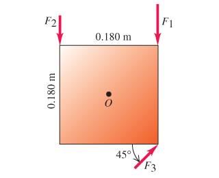

3)A square metal plate 0.180 m on each side is pivoted about an axis through point O at its center and perpendicular to the plate
Calculate the net torque about this axis due to the three forces shown in the figure if the magnitudes of the forces are F_1=18.0N, F_2=24.0N, and F_3=14.0N. The plate and all forces are in the plane of the page. Take positive torques to be counterclockwise.
Ok so i know that the effective lever arm r is perpendicular to O so for torque_1 is did T_1=18.0N*.09m=2.34 N*m and for T_2 similarly i did T_2=24N*.09m=1.62N*m but for T3 I am stuck... after i found all the individual torquest are they simply added together for net torque or must i multiply by and angle between them all?

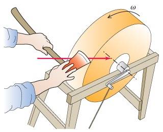

4) A grindstone in the shape of a solid disk with diameter 0.460m and a mass of = 50.0kg is rotating at omega = 840 rev/min . You press an axe against the rim with a normal force of F = 220N, and the grindstone comes to rest in 7.00s .
Ok i thought this one was going to be easy but i was wrong. I tried using W_other=-K1 since my other works canceled out. i converted omega into rad/s and for K1 i got -5116J. W_other should be the force times the distance it was done at correct? what i did was soemthing like d=r*t but i did d=omega*t and also tried using the tangent v=omega*r to find the distance that the friciton force acts to get its work.
Anyone see where I am goin wrong or have a better method on this one?
