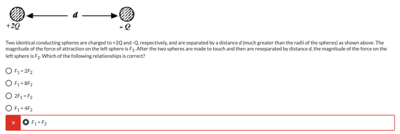

Two identical conducting spheres are charged to +2Q and -Q, respectively, and are separated by a distance d (much greater than the radii of the spheres) as shown above. The magnitude of the force of attraction on the left sphere is F1. After the two spheres are made to touch and then are reseparated by distance d, the magnitude of the force on the left sphere is F2. Which of the following relationships is correct?
Coulomb's Law: F=k|q1q2|/r^2
Here are the answer choices:
a) F1 = 2F2
b) F1 = 8F2
c) 2F1 = F2
d) F1 = 4F2
e) F1 = F2
I figured that Coulomb's law would tell us the magnitude of the forces are identical, so I answered E, but that was incorrect.
(Screenshot of question attached)

After the spheres touch, how much charge is on each?
Equal amount, so does each sphere then have 1/2 Q charge?
Yes, well done.
The total charge is (2Q) + (-Q) = Q. Since the spheres are identical, this total charge gets split equally, ##\frac Q 2## each.

Good.
Now finish off. What are the before & after forces?
