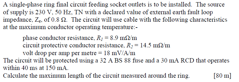

Hi all
Wondering if anyone can help. Really don't know where to start
I know Zs = Ze + Z1 + Z2
and Z1 = PCR 8.9 milli-ohms/meter
and Z2 = CPC 14.5 milli-ohms/meter
which equates to 0.0234X milli-ohms/meter over X meters
but where does my volt drop come in if I don't know my current?
