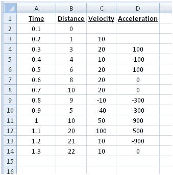

Here is a simple example using Excel. The sample time base is 0.1 seconds between samples, and I made up the position (Distance) numbers. The equations for the velocity and acceleration are as follows:
Velocity calculation in cell C3: =(B3-B2)/$A$2
Acceleration calculation in cell D4: =(C4-C3)/$A$2
Likes btb4198

Thanks! I understand how to do this now. One question
should it be
(y2-y1) / ( x2-x1)
because you have :
C3: =(B3-B2)/$A$2
what about x1 ?
Likes berkeman

My sample intervals were on the even 0.1 second marks, so t2-t1 = t1 for that case. Makes sense? If the sampling were not on the same time interval, then yes you would need to compute the delta-t for each case.

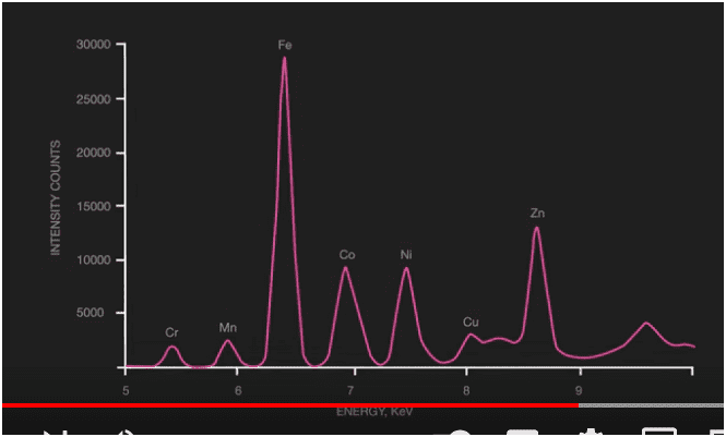

Mark,
Please watch this video : What is X-ray Fluorescence (XRF)?
It will explain the spectrum output of my Digital Pulse Processor (DPP).
Does this help?

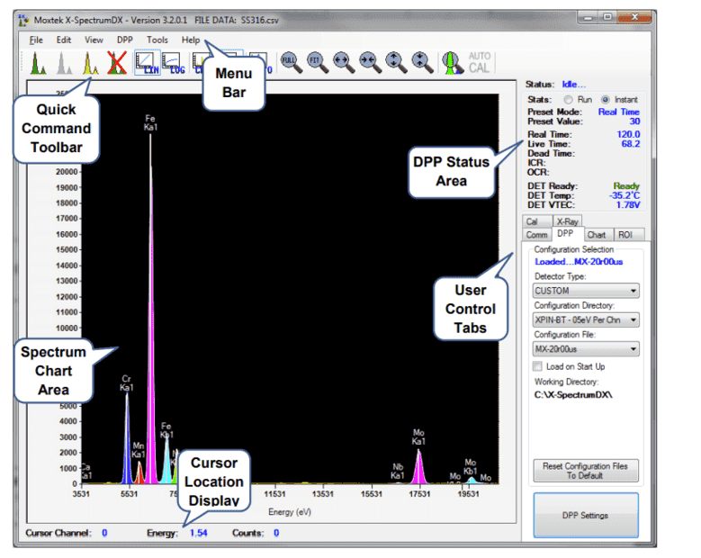

Hi sorry I just update. That is the DPP I am using.

So your "1-dimensional data" is really this 2-dimensional data in the plot (counts per energy bin), and you want to take the 2nd derivative of the data for some reason?
But what do you want to compute the second derivative from and why? From the curve that can be sensed from that graphic? If so, then you need an analytical approximation for that curve. One way to do so is to mark several crucial points ##(x,y)## where ##x## denotes the value of the horizontal axis and ##y## the one of the vertical axis. Then you can set up a polynomial ##p(x)=a_0+a_1x+a_nx^2+\ldots+a_nx^n## with ##n## one less than the number of points you have chosen, and solve for ##p(x)=y## for your points. This gives you the values for the ##a_k## and you can differentiate ##p(x).##
