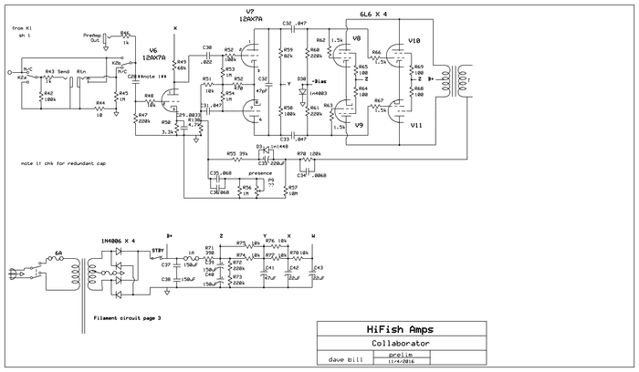

Here is the schematic showing the PA and the HT part of the power supply. The B+ loaded voltage is 480 VDC with 5.19 VAC ripple. There is very little ripple past the B+. This ripple is 120Hz.

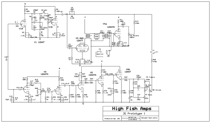

Here is the Preamp. The channel switching is not installed yet and the effects loop is not connected to the jacks.
Billy
I see that the FS Jack Ground is connected to Chassis Ground, not to the Power Supply common. If this isn't a problem now, it could be when the rest of it is straightened out.

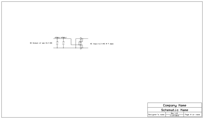

Hi Tom,
I have the bridge built as above. Unloaded it measures 8.31 VDC RMS unloaded. The 6.3 VAC tap on the transformer is also powering the four 6l6gc output tubes (AC) which I did not indicate on the schematic above. With the seven 12AX7 preamp tubes connected the voltage is 6.3 VDC. I have around 500 mv of ripple. I think something is not correct in the bridge because when I set the scope to DC, I should see pulsating DC and not a sine wave. I don't understand how a AC signal could be coming through the bridge. For sure I have 6.3 VDC coming from the bridge loaded, measured with both the scope and a DMM. I also have a 120hz AC @ .48VAC
In some testing I did, I hooked up a regulated power supply set at 6 VDC (connected to the 7 preamp tubes) and the current was around 1.8 amps as I remember. I was a bit surprised as I thought it should be drawing more current than that. Actually I just looked at the datasheet again and it shows .3 per tube so the 1.8mv total may be a real number. The heaters can be run AC or DC. The whole idea of the DC heaters was to reduce hum.
In some things I have read somewhere between 4700uf and 10000uf is "normal" filtering.
Something is messed up here!
Billy

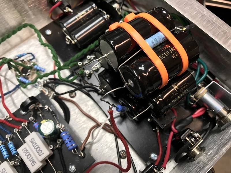

As much as I don't want too I need to take the main circuit board out and record the jumpers on the back side and make an as built drawing.

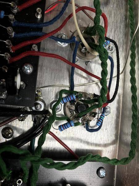

Your circuit board has many connections on the tubes side, less on the knobs side. If you ran the wires on the knob side under the board, then round and over to the appropriate point, you could hinge the board along the tube edge without disconnecting anything. That would make service easier.
The hum may be being caused or made worse by the style of wiring . All those loops and crossing wires could be picking up mains frequency and other stray signal inputs and feeding them back into the system .

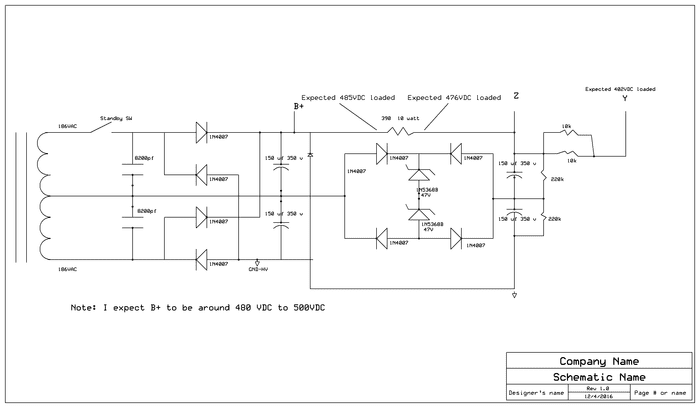

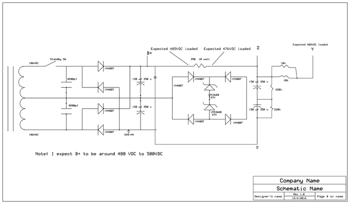

Here is a possible design for the new HT part of the power supply. See any issues?
Thanks,
Billy
EDIT: there should be a couple of 220K resistors in parallel with the second set of 150 uf caps.

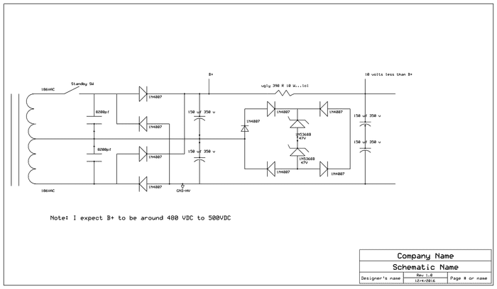

Yup. When you figure out where to connect the Anodes of the right-most 1N4007s all the magic smoke will come out of the Zeners and maybe out of the 1N4007s.
Below was being written when the latest schematic was posted.
Inspecting the build photos again though, I find some of the suggestions may already exist. Can't tell for sure.
You keep referring to Channel One and Channel Two but the schematics don't show any such labels. Which is which?
The Power Supply schematic shows the CT of the power transformer high voltage winding thru a fuse to the bridge output. This should not be! I hope it is only a drawing error and not "as built."
The schematic also shows the 6L6 Cathodes to be floating.

The scope traces look as expected for the DC heater circuit. You may want to put a 100 Ohm 1/2W resistor from both the Plus and Minus of the bridge to HT minus (B-), that should reduce any hum from the heaters. Considering the scope traces, the cap values look OK.
Planobilly said:
I have come to the conclusion that the whole power supply needs to be redesigned.
I don't think that's needed; although without seeing scope traces of the various B+ voltages under load I can't say for sure.
I see the input to V1A and V2A is DC coupled though; not a good idea for this usage. Put a series 0.2uF after the input jack, this will give low freq. rolloff around 60Hz.
Another thing that may help is connecting the B- to chassis. That connection should be at the C38 - C40 junction, where the Minus bridge output connects.

The 1n4007 right after the bridge is drawn in the wrong place and I will correct the schematic as the anode need to connect to the 220K resistors I left out. Sorry, not enough coffee I guess. (the last schematic I posted a few min ago)
As for the HT circuit, the center tap is connected to ground through a fuse. The two other leads are connected to the bridge. There have been so many changes that the original schematics are not as built.
Try disconnecting the CT connection (pull the fuse?) and connect the C38 - C40 junction to chassis.
What is the value of the resistors connected across the DC heater supply, and what does there common point connect to?
I created a center tap for for the 6.3 AC heater tap at the output tube with two 120 resistors going to ground. So the 6.3 AC is connected at the input of the bridge and also jumps over to the last output tube where the two 120 resistors go to ground. I have all the heaters wired AC at the moment. The way it is drawn in post 19 is the way the 6.3 DC heater circuit has been connected.
Just so I understand, the HT center tap will not be connected and a new connection will be made from C38 junction.
For AC heaters that's fine. For DC heaters you should get better results with the resistors on the DC side of the bridge, at the filter capacitors.

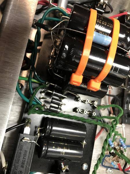

It is 2AM here and I am getting a bit tired. The HT cap in question are a bit of a stacked up mess. I think it better to make these changes tomorrow. I don't want to make some stupid mistake being tired.
I just went back and looked at the schematic in post 6 which I assume you are looking at and looked at the amp. There is a connection to ground now on the negative side of C38. So I assume I just need to pull the fuse? I can take a photo if you like. I can do that now.
The four turrets in the center are the output of the DC bridge. The green twisted coming out between the caps are the AC wires to the output tube with the two 120 ohm resistors going to ground. There is a black wire to ground from from the cap (C38) The white wire goes to the output transformer
On the back side of the bridge the green and green/yellow wires come from the transformer. The two dark green plastic coated wires go to the pilot light. The cloth covered twisted wires go to the last output tube and the 120 ohm resistors go to ground there.
Perhaps better photos...I hope that helps.
I expect that fuse from the CT to chassis is blown, and perhaps a diode or two in the B+ rectifier bridge. Just hang your scope on the B+ to verify the ripple is 120Hz. If it's 60Hz then a diode has met its end-of-life.

Redraw of the possible new HT power supply circuit.
Also the current HT bridge does not have a blown diode as the ripple is 120Hz.
  • #32
Have you covered the bottom of the chassis with a shielding material like an aluminum sheet? Also is the scope prorerly grounded?
  • #33
So - what is the diode bridge with the zeners doing? One end is connected to the transformer center tap, the other is floating in the air?
  • #34
Just a couple of general points: make sure the power supply ground is _between_ the filter caps and the rest of the circuit. Otherwise, the bypassed current will be pumping circuit ground.
Always make sure you know where every return path is for every current you use and make sure the forward and return paths/loops have as small an area as possible.
Pretend that the scope ground is 200V@5amps away from the ground of your power supply and hook the scope ground up so that the current will not go through any circuit ground paths. Unless you have a special scope life will be easier.
  • #35
Arydberg...Yes and Yes
Svein... More drawing mistakes...sorry...the zener idea is to stabilize the grid supply.
Rrogers...I assume you mean I should remove the first ground I have on the above schematic. I will have to think about your scope comment. I don't have much experience with a scope to begin with...still learning.
Thanks,
Billy
