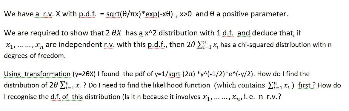

We have a r.v. X with p.d.f. = sqrt(θ/πx)*exp(-xθ) , x>0 and θ a positive parameter.
We are required to show that 2 θX has a x^2 distribution with 1 d.f. and deduce that, if x_1,……,x_n are independent r.v. with this p.d.f., then 2θ∑_(i=1)^n▒x_ι has a chi-squared distribution with n degrees of freedom.
Using transformation (y=2θΧ) I found the pdf of y=1/sqrt (2π) *y^(-1/2)*e^(-y/2). How do I find the distribution of 2θ∑_(i=1)^n▒x_ι ? Do I need to find the likelihood function (which contains ∑_(i=1)^n▒x_ι ) first ? How do I recognise the d.f. of this distribution (Is it n because it involves x_1,……,x_n,i.e. n r.v.?
