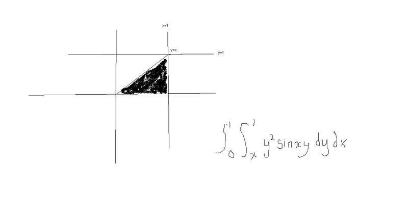

Given the integral shown (in attachment), make a sketch of the region of integration, express the integral with the order of integration reversed and evaluate the integral after reversing the order of integration
So i got the limits as y<= x <= 1 and 0 <= y <= 1
But for the function y^2 sin xy dxdy, how should i integrate that. Integration by parts would not work because v= 0 so the whole integral becomes 0. Should i just read it off the table of integrals. if i do that, the integral becomes -y^2cosxy dx rite?
