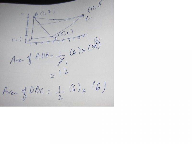

Hi,
I got a question from a book to find the area of a Quadrilateral. I divided the quadrilateral into two triangles but answer is not correct. Some body please guide me.
I am uploading my work in a attached file.
Zulfi.
For ADB, did you write ##A=\frac {1}{2}(6)(4)^2##?
And is triangle DBC a right triangle?
Oh, and this should also be in the homework forum, not general math.
For ADB is correct. For the second isn't simply ##\frac{1}{2}6\times 6##, hint: calculate ##BD## and ##DC## (that are not ##6##) ...

Hi,
Thanks for replies. This is not a hw. Its exam preparation. But i would put my future questions related to book in a homework forum. I think you judge hws with the usage of books?
BD= sqrt(sqr( 5-1) + sqr(1-7))
= sqrt(16 + 36)
=2 *Sqrt(13)
Ans=? (I can't use calculator in exam)
DC = sqrt(sqr(11-5) + sqr(5-1))
= sqrt(36 + 16)
= 2*sqrt(13)
area of DBC = 1/2 (2*sqrt(13)) * ( 2 *sqrt(13))
Ans = 26
Area od ABCD = 26 + 12 =38.
This is the correct answer. Thanks.

How do you know that ΔDBC is a right triangle ?
Likes ProfuselyQuarky
Hi,
No I am not saying that DBC is a right angle triangle. That's why i think they have asked me to use distance formula. However from fig it looks that ABD is a right angle triangle, so i am not using distance formula here and calculating the area directly using 1/2 alt * base formula.
I also have a question:
for triangle DBC why are we using sides DB & DC? why can't we take sides DB & BC??
Zulfi.

What are you using as a formula to calculate the area of a triangle ?
The altitude is the perpendicular distance from the base to the opposite vertex.

That is why I asked whether DBC was a right triangle or not. If DBC is not a right triangle, then you can not you ##A=\frac {1}{2}bh## to find the area. Instead, you have to use Heron’s theorem which states ##A=\sqrt {(s-a)(s-b)(s-c)}## where ##s=\frac {1}{2}(a+b+c)## and variables ##a##, ##b##, and ##c## are the sides of the triangle.

One easy way to solve this kind of exercises is a variation on the "box method", illustrated here for the area of a triangle.
Add the points E(11,7) and F(11,1) to your graph, and the area of ABCD can be easily computed:
Or decompose your quadrilateral as follows:
