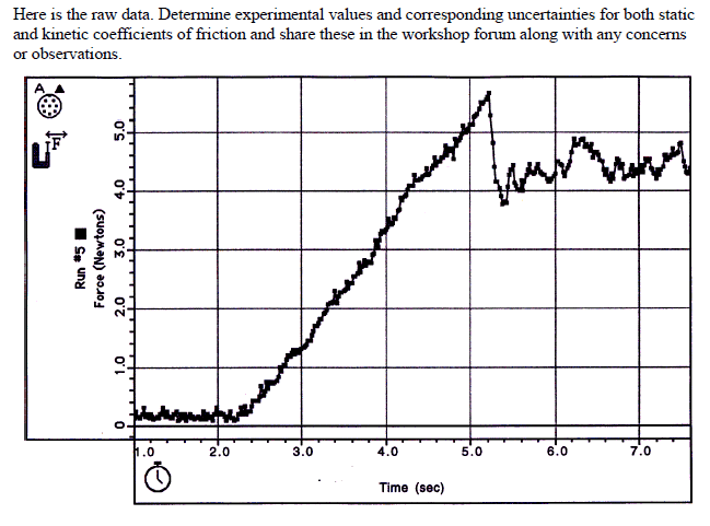

From a force time graph. Normal force is (18.20 ± 0.01) . I need to find μstatic and μkinetic. I also need to find uncertainties
μstatic = F,ax static / F normal
μkinetic = F friction/ F normal
I have found that μstatic= 5.6 (found on graph) / 18.20 = 0.3077
I don't know how to find Force of friction from the graph to calculate μKinetic

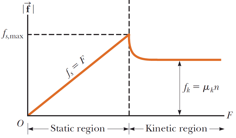

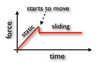

Do the following figures help you understand what you are looking for? Each one is a more ideal representation of the previous one.

Yes, I found both coefficients with μstatic= 0.3077 and μkinetic= 0.2473

The graph shows a force of approximately ##5.6 \ N## when the brick starts to move. What is the uncertainty in that value? Could it be ##5.5 - 5.7 \ N##? Or, perhaps, ##5.4-5.8 \ N##?

But the nature of the graph changes quite a bit between the static and kinetic cases. When the object is moving, you'll notice the graph shows the force measurements jumping around a lot. You can describe the data by estimating a value around which the force measurements seems to fluctuate (this would be your best guess for what the actual value of the force kinetic friction is) and a value for how big the fluctuations are (this would be the uncertainty). Can you give us your estimates for those two numbers? You're probably just meant to estimate these values by eye from the plot.

One thing that bothers me about the question is that we do not know how the force is being measured in the kinetic phase. This could affect how best to estimate the coefficient.
Here is the beginning of the lab writeup taken from the pdf posted by OP. I would assume that the brick is pulled by a force increasing constantly in time until the brick starts moving. The plot is the digitized output of the force sensor. I would trust the data logging interface to record and report accurate time and force measurements.
If I were analyzing this, I would first draw an eyeballed baseline through the fluctuations and call that the force of kinetic friction. It is safe to say that the fluctuations are real and not noise, most probably a manifestation of the stick-slip phenomenon. For the uncertainty in ##\mu_k##, I would draw two parallel lines going through the maximum and minimum values, measure the separation between them and call a fraction of that, say ##\pm \frac{1}{3}\delta##, the uncertainty in the force. Why ##\frac{1}{3}## and not some other fraction? Because it sounds reasonable. Surely, ##\frac{1}{2}## is too much, ##\frac{1}{5}## is not enough and I won't quibble about ##\frac{1}{4}##. This is an estimate after all.

The extract you posted shows there is a feedback involved. The characteristics of the feedback could be significant.
If it were stick-slip I would expect the peak to keep returning to the max static friction force. And we'd better hope it is not or taking the average force in that phase will overestimate the kinetic friction.
If we assume the block never ceases to move and the average acceleration over the kinetic phase is negligible then averaging the force seems ok. But maybe ignore the bit before 6 sec on the basis that the feedback is still adjusting to the rush created by the transition to kinetic.

If the data points are available in digital form then how about taking a standard deviation or two?
Ignoring the bit before 6 sec would be a good idea. Taking a standard deviation (or two) would be the way to go but, pending OP's confirmation, the writeup with the plot looks like all that is given.
