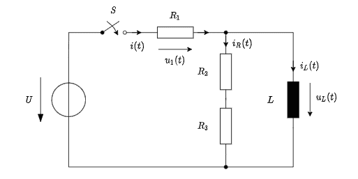

The following circuit is given, where the switch S is closed at time t=0.
a) Set up the general differential equation (DE) for the current i(t) and bring the result into the following form## \frac{di(t)}{dt} +c_1 i(t)=c_0,## with the constant terms c0 and c1.
Hint: Determine the DE using Kirchoffs laws
b) established ODE.Use here for the exponential approach,i.e. ##i_h(t)=ke^{λt}. ##
(c) Determine the particular solution of the DE
(d)Determine the constant k
(e) Find out the values when i(t) aproaches 0 and infinity, as well as for ## u_L (t) ## Sketch them in a graph
Okay so I'm having problems right at the start. So first I figured that ## i(t) = i_R(t) + i_L(t) ## Using the loop law I get; ## U = u_1 + u_L(t) ## and I can rewrite that as ## i(t)R_1+ L\frac{di_L(t)}{dt} ## now I have rewritten the first equation to look like this; ## i_L(t) = i(t) - u_L(t)(R2+R3)## and now what I have tried is plugging in the first equation in the second one.
$$ U = i(t)R1 + L \frac{d}{dt} (i(t) - u_L(R2+R3) $$ and here is the problem.I get the derivative of di/dt but I'm stuck with this voltage.Usually its a constant term meaning after deriving it simply goes to 0. Now I've tried mixing it up but the same problem persits.I've went ahead and done the rest of the problem,under the assumption that the UL term goes to 0,and the solutions look right ( I get the the right time constant). Can it be that the voltage really goes to 0, if so why? If not what am I doing wrong than?

One obvious mistake I see is that ##u_1(t)=i(t)R_1## please fix that and hold on while I think over this more.
You have confused me with your approach. One equation is for sure from the KCL $$i(t)=i_R(t)+i_L(t)$$.
Write two more equations from applying KVL in any two of the 3 possible loops and express everything in terms of currents, so if you have ##u_L## for example, write it down as ##L\frac{di_L}{dt}##.
At the end you will have a system of 3 DEs with 3 unknowns the 3 currents ##i(t),i_R(t),i_L(t)##.

Why us u1 = i(t)•R1 wrong? Is not the voltage current times resistance? Than for the other equations ; The first one is KCL,but I do not see the other two? I have one KVL and that is U = uL • u1 and I have (at least tried) expressing it in terms of currents (see post #1). Where do I find the third equation?
yes sorry i meant you seem to have ##u_1=\frac{i(t)}{R_1}##. The other KVL is ##u_L=i_R(t)(R_2+R_3)##.
The three equations are $$i(t)=i_R(t)+i_L(t)$$
$$L\frac{di_L(t)}{dt}=i_R(t)(R_2+R_3)$$
$$U=i(t)R_1+L\frac{di_L(t)}{dt}$$

Actually I think there is an easier way, the solution for ##i_L## seems to lead to an integral equation which I ve never seen before, so its better to eliminate ##i_L## and ##\frac{di_L}{dt}##.
First use (2) and (3) to eliminate ##\frac{di_L}{dt}## and find ##i_R(t)## in terms of ##i(t)## call that equation (4).
Then take the time derivative of (1) and replace ##\frac{di_L}{dt}## in (2), call that equation (5)
In (5) replace ##i_R(t)## with what you get from (4).

Got it. I have been trying really hard to replicate your method of getting the equation for i(t) but I think I am making a mistake somewhere. Here is how I tried it;
So we want to use (2) and (3) to eliminate the derivatife of iL. This is how I've tried it
(3) ## U - i(t) R_1 = L \frac{di_L(t)}{dt} ## Now plug this for the derivative in equation two and find iR(t)
## i_R(t) = \frac{U-i(t)R_1}{R_2+R_3} ## We call this equation (4) Now here is where I think I got something wrong. "Take the time derivative of (1) and plug that for the derivative of iL" ; Deriving (1)
$$ \frac{di(t)}{dt} - \frac{di_R(t)}{dt} = \frac{di_L(t)}{dt} $$ And now I am assuming I need to plug this into the original (2) equation? That should look like this;
$$ L (\frac{di(t)}{dt} - \frac{di_R(t)}{dt}) = i_R(t) (R2+R3) $$ Now I'm susposed to find iR here call that equation (5);
$$ L (\frac{di(t)}{dt} - \frac{di_R(t)}{dt}) * \frac{1}{R2+R3} = i_R(t) $$ so this should be equation 5
Now if I replace iR in (5) with what I have from 4 ;
$$ L (\frac{di(t)}{dt} - \frac{di_R(t)}{dt}) * \frac{1}{R2+R3} = \frac{U-i(t)R_1}{R_2+R_3} $$
Now the problem is this derivative of iR? Where did I make a mistake?
Likes Delta2
correct so far (with some minor typos) hold because i am abit busy atm.
Take the time derivative of (4) and replace the derivative in the final equation of your last post.
Likes arhzz
Deriving 4;
$$ \frac{di_R(t)}{dt} = \frac{U}{R2+R3}' - \frac{i(t)R_1}{R2+R3}' $$ First one should be 0; the second one
$$ -\frac{R1}{R2+R3} \frac{di(t)}{dt} $$ so 4 derived is;
$$ \frac{di_R(t)}{dt} = -\frac{R1}{R2+R3} \frac{di(t)}{dt} $$
Now plugging that into equation 5
$$ L (\frac{di(t)}{dt} -(-\frac{R1}{R2+R3} \frac{di(t)}{dt}) *\frac{1}{R2+R3} = \frac{ U - i(t)R_1}{R2+R3} $$
Seems like I have 2 derivatives of i(t) now
Likes Delta2
er yes you have two derivatives but that's not a big problem for algebra, use something like ##a\frac{dy}{dt}+b\frac{dy}{dt}=(a+b)\frac{dy}{dt}##.
You can treat the derivative as a normal real number here when you going to apply the distributive property of multiplication with respect to addition, that is ##ad+bd=(a+b)d## where ##d=\frac{di}{dt}##.
Ahhh okay, so now it is time for some algebra
$$ \frac{di}{dt} \frac{L}{R2+R3} +\frac{di}{dt} \frac{R_1L}{(R2+R3)^2} = \frac{U-i(t)R1}{R2+R3} $$ I've multipled both sides by R2+R3 and factored out what remains with the derivatives
$$ \frac{di}{dt} (L + \frac{R_1L}{R2+R3}) = U - i(t)R1 $$ Make the bracket to one fraction and move i(t)
$$ \frac{di}{dt} (\frac{L(R2+R3)+R_1L}{R2+R3}) +i(t)R1 = U $$ Now divide with the contents of the bracket should give me;
$$ \frac{di}{dt} + \frac{i(t)R1(R2+R3)}{L(R2+R3) +R_1L} = \frac{U(R2+R3)}{L(R2+R3) +R_1L} $$
By no means the pretties DE but I think its right no? I don't see any further simplifications.

Yes I think its correct.
