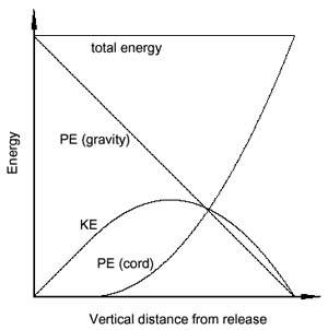

Please, see:
https://stokes.byu.edu/teaching_resources/bungee.html
Likes Steve4Physics
Steve4Physics said:
That's an interesting graph - there is a point where the three types of energy are equal. Not sure if that's generally true or just an accident due to the way the drawing has been done.
It seems to depend on the slack length divided by the maximum drop being ##\frac{3-\sqrt 3}6##.
Likes Steve4Physics
