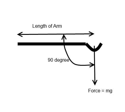

Buggsy GC said:
I think I figured out the spring constant for different tightness of the rope, by using fishing weight, to weigh the arm down to firing position, and then using Newtons second law to calculate the force of the weights on the arm. I imagined that the force of the weights is equal to the force of the spring but in the opposing direction, it worked out that the less taught the rope the less weight were need as i expected.
I think you need to measure the change in torque between the rest position and the firing position (in Newton Meters)
But I have no idea how to measure the displacement, or if the normal hooks law formula even applies for a torsion spring
The displacement is the change in angle between the rest position and the firing position (in Radians).
The spring constant is one divided by the other.

Buggsy GC said:
How do I measure the change in torque, I thought torque was the equivalent to Force except in the rotational axis e.g. F=ma, and τ=ια
Torque = force * radius
If you are hanging weights on the arm the radius is the distance from the pivot to where the weights are attached.
awesome so originally I just placed the weights on the firing cup, so does that mean I can just use the distance from the cup to the pivot point. and then once I have the torque of the spring I can rearrange the Equation τ=-kθ^2 to -τ/θ^2=k, and this will give me the spring constant for the torsion rope spring of my catapult
Yes although strictly speaking you need to ensure the force (gravity acting on the weights) is at 90 degrees to the arm otherwise you need to calculate the lever arm length as ..
Likes Buggsy GC
Eg measure the torque like this...
thank CWatters and every one else this was a huge help. also even though we are dealing with rotational motion the angle can still be measured in degrees instead of radians correct, also would the PE of the spring 1/2kθ^2 still
