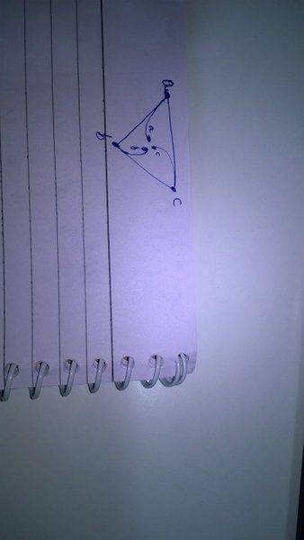

Sam has three dogs sitting at the vertices of an equilateral triangle. The length of each side of the triangle equals to s meters. Sam gives the command "Start!" and each dog starts to run with constant speed v meters per second. At each moment, each dog is running towards the dog just right to him (in counter-clockwise direction). Therefore, their trajectories are forming some spirals that converging to one point as shown in the attachment.
How long does it takes dogs to meet each other after the command "Start!"?
Time = Distance / Speed
For Speed = 5 and Side = 2
Approximate answer is 0.266667. But I don't know how to get that.I'm struggling to find the distance the traveled by the dogs.
Once I have got the distance , I can plug it in the above formula to get the time.
I know I'm certainly missing something .
Any help would be appreciated.

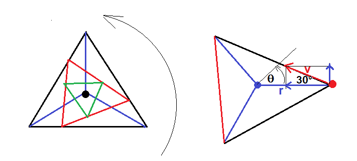

The dogs are always at the corners of an equilateral triangle, each of them running towards the next.
What is the velocity of the second dog (red) with respect to the first one(green)? The arrows represent the velocities. You can take that the green arrow points to the positive x direction.

  • #32
Because of symmetry, the dogs are at the corners of a equilateral triangle all times. The triangle rotates and shrinks with time, and it becomes a point at the end, at the centre of the original triangle. Both the time when the dogs meet and their trajectory can be easily obtained in a polar system of coordinate. The sides of the original triangle are of length a.
The radial and tangential components of the velocity vector of a dog (represented by the red dot now) are vr=dr/dt=-vcos(30°)= -v√3/2. The tangential component is vθ=rdθ/dt=vsin(30°)=v/2.
The radial component is constant, so the radius is r=r0-√3/2 vt. At t=0, r=r0=a/√3. When the dogs meet, r=0, the time is
t=2/3 a/v.
The equation for θ is dθ/dt=0.5v/r Substituting r=a/√3-√3/2 vt and integrating, we get the time dependence of the angle. The trajectory is obtained by eliminating the time, but also using that dr/dt=dr/dθ dθ/dt, that is,
##-v\frac{\sqrt{3}}{2}=\frac{dr}{d\theta}\frac{v}{2r} ##
Integrating, the trajectory is ##r(\theta)=\frac{a}{\sqrt{3}}e^{-\sqrt{3} \theta}##
