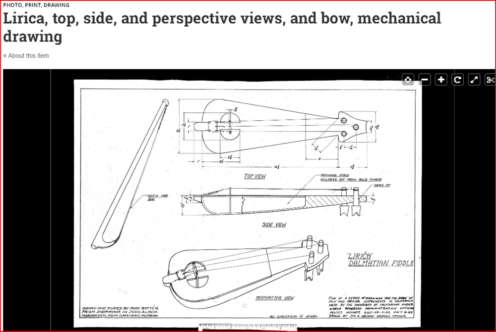

Have you taken any CAD drawing courses yet? If you have access to a 3D printer at your school (or through the clubs and Maker resources mentioned above), you can start to draw and print some objects that you can use in your daily life. You can start with hand sketches (3-view and perspective), then draw the plans up with a 3D CAD package (there are student versions and free versions available -- check to see what your school & ME department use), and then print the object out and see how close it is to your original sketches. Pretty fun, and also very applicable to your ME course of study.
What are some things that come to mind that you might like to 3D print for yourself? :smile:
https://www.loc.gov/resource/afc1940001.afc1940001_d28201/
