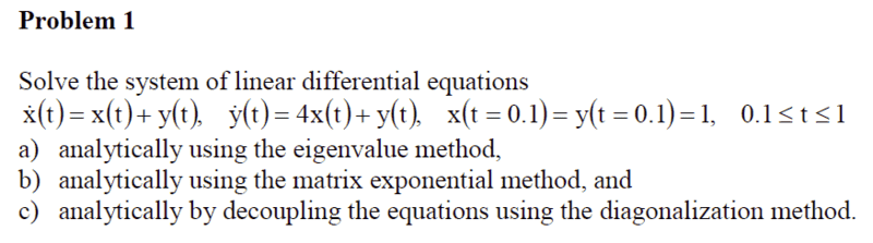

I'll keep the uppercase letters in mind. The actual problem is attached, I am trying to solve part B. Also, won't plugging in t = .1 eliminate my solution?
Why do you think that would happen? Did you try what I suggested?
[1.238 1.572]' = [1 1;2 -2]*[e^(3*.1) 0; 0 e^(-.1)]*[.5 .25;.5 -.25]*[1 1]'
That does not look like a solution to a differential equation.
I agree. Part of my confusion is in trying to make sense of this:
X = [1 1; 2 -2] * [e^(3t) 0; 0 e^-t] * [.5 .25; .5 -.25] * x
The original system of differential equations involves x(t) and y(t) and their derivatives. In your solution what do X and x represent?
Your solution should start off with ##\begin{bmatrix} x(t) \\ y(t) \end{bmatrix}##, which is probably what you should have in place of X. For x, you should probably have your vector of initial conditions.
The matrix in the middle on the right side, with the exponentials, should be left as is. Otherwise, you should multiply things out to give equations for x(t) and y(t).
When you're done, check your solutions to ensure that
1. x(.1) = 1 and y(.1) = 1, and
2. x(t) and y(t) satisfy the two differential equations.
If both of the above check out, your solution is correct.

X is the solution
X = [x y]'
Initial condition at t = .1
x = [1 1]'
If I solve this I get:
.75e^(3t)+.25e^(-t) = x(t)
1.5e^3t - .5e^t = y(t)
No I will not get x = 1 and y = 1 when t = .1
I already have the solution from solving part A using the eigenvalue method. I can't get it with the matrix exponential method.

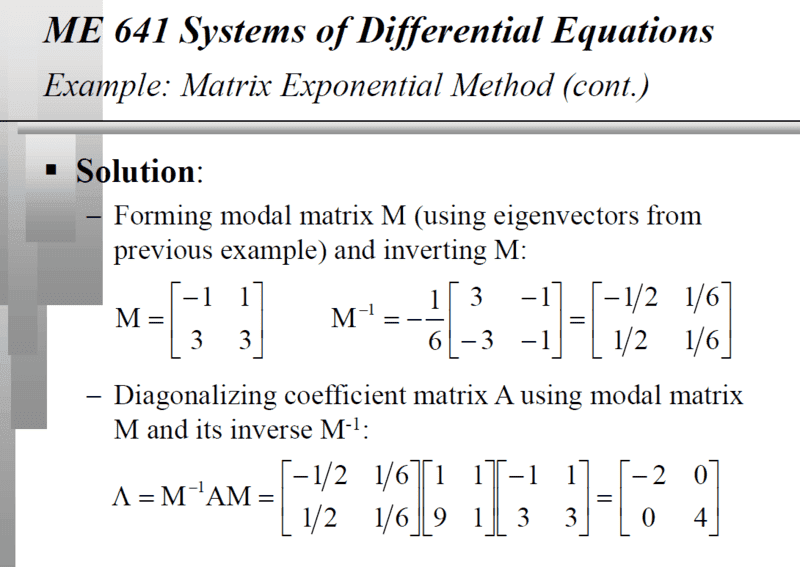

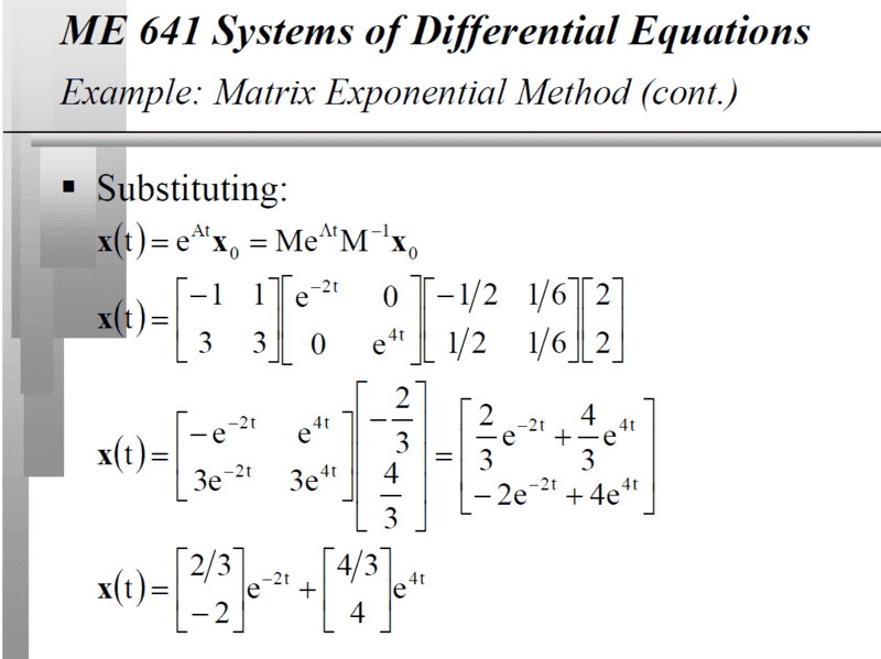

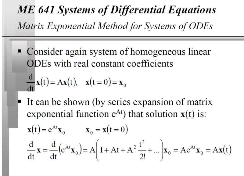

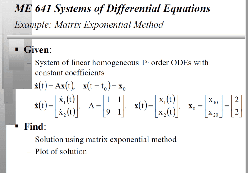

Yes, I used the eigenvalue method to solve part A. I need to solve part B using the matrix exponential method.
If it helps, here are the slides of the method I am trying to follow.

You have that
$$\exp(A t) = M \pmatrix{e^{3t} & 0 \\ 0 & e^{t}} M^{-1} = E_1 e^{3t} + E_2 e^t,$$
where
$$E_1 = M \pmatrix{1 & 0 \\ 0 & 0} M^{-1}, \:\text{and}\; E_2 = M \pmatrix{0 & 0 \\ 0 & 1 } M^{-1}.$$
The solution will be of the form
$$\mathbf{x}(t) = \pmatrix{x_1(t) \\ x_2(t)} = \left( E_1 e^{3t} + E_2 e^t \right) \pmatrix{a \\ b} \equiv \mathbf{u} e^{3t} + \mathbf{v} e^t \hspace{4ex}(1) $$
for some constants ##a,b## and associated constant vectors ##\mathbf{u}, \mathbf{v}.##
This implies
$$\pmatrix{1\\1} = e^{0.3} E_1 \pmatrix{a\\b} + e^{0.1} E_2 \pmatrix{a\\b}.$$
I figured it out. I needed
e^A(t-t0) t0 = initial time = .1
M*e^A(t-t0)*M^-1 = X(t)
Thanks for taking the time to try and help.
