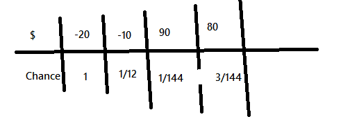

Here is my attempt at it
After multiplying every correlating x and y value i get E(X) = -18.5, meaning the profit the ones running the game make is $18.5

It would help if you labeled the columns so that it is clear what series of results each represents. I am not sure what the 3'rd column ( -10, 1/12 ) represents. They should all be labeled so you can check that all the possibilities are accounted for exactly once.
You should do an analysis where the probabilities of the possible outcomes add up to 1.
List all the different experiences a player may have and the probability of each of those experiences. Those probabilities should add up to 1 if you have made a complete list.

There an obvious mistake, in that the probability of winning $100 should be twice that of winning $110. You have it as three times.
I also think you may be double counting the $10 win.
It's better to keep the losses out of it. Just calculate the expected winnings per game. Then subtract this from the $20 stake.

Thank you. I made a chart saying there is a (1/2)(1/6) = 1/12 chance to win $10, and that there is a (1/2)(3/6)(1/12) = 1/48 chance to win $100
after multiplying the prizes and subtracting the starting fees ($20) I got $-17.083333 per play.
That's what I got also.
