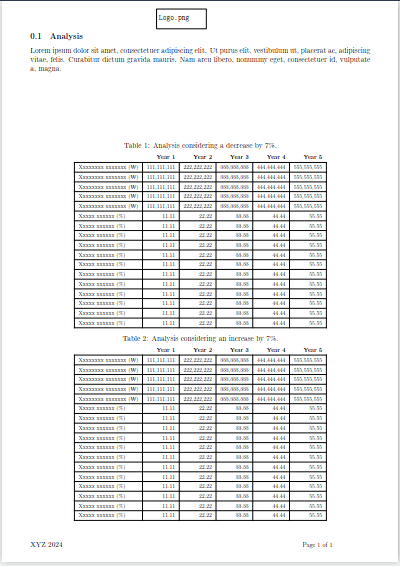

The reason there are two NiceTabular environments inside one table environment is that I want to fit both the tables in this page. If I separate them, one table is always going to the second page.

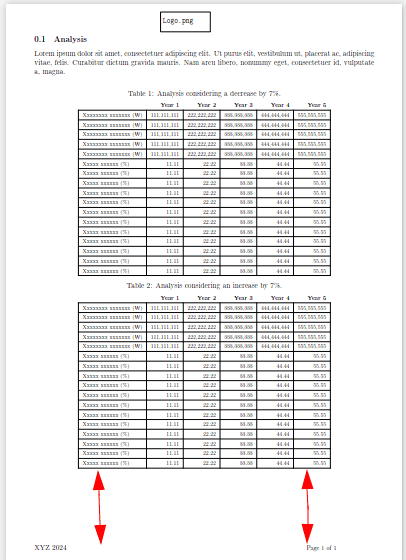

The output looks like this, with the space I am referring to highlighted:
If I use \vfill above the table environment, the entire table gets shifted down, as expected:
But using \vspace{} or \vspace*{} anywhere between the two NiceTabular environments results in the entire thing going to the next page, even if the space is tiny, like 7pt. The existing space looks far greater than 7pt, though.
Any idea how I can insert some space between the two tables without them going into the next page?
