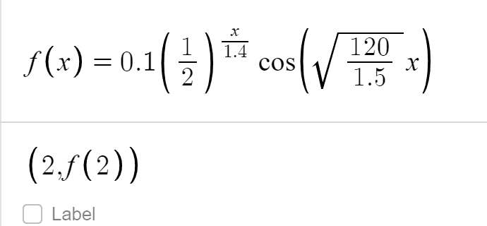

A spring with an upstretched length of 50.0 cm and a spring constant of 120.0 N/m is suspending a 1.50 kg mass below the ceiling. if the mass is pulled down 10.0 cm from its equilibrium position and released we notice that the vibration has a half life of 1.40 s. What is the position of the mass at t = 2.00 s?
Fe = Fg
x = Δx(1/2)^t/λ*cos(sqrt(k/m)*t)+c
I first solved for the extension of the spring when its at equilibrium w/ the mass. I got Δx = 0.122m. I thought that if I added this with 0.1m, this would give me my amplitude. I then set 0.5m as my c value and plugged the rest of my values in from there. What am I doing wrong?

So my net force would be equal to Fs = Δx*k in both directions, right? I'm writing it out now and I get a magnitude of 60N in both directions as I'm using 50cm as Δx since that's the length when the spring is upstretched, would this be correct? And if so, would I have to consider the value I got for Δx in Δx*k = mg as the c value instead?

Would it be 0.1m + 0.122m?
Look at the expression your teacher gave you.
Clearly, ##\Delta x## is the displacement of the mass from the equilibrium position.
Variable ##x## on the left-hand side is the position of the mass. Position requires an origin. Where is the origin here, at the unstretched end of the spring or the equilibrium position?

Wouldn't it be at the unstretched end?
No.
At the equilibrium position, ##k x_{eq}=mg##. The net force on the mass is zero.
At any downward displacement from there, to ##x_{eq}+\Delta x##, the net upward force is##k(x_{eq}+\Delta x)-mg=k\Delta x##.
This means you can forget about mg and ##x_{eq}## because they always cancel. What you are left with is a displacement of ##\Delta x## from the equilibrium position and no gravity.

Ok, so then would my Δx just be 10cm as that's the displacement from equilibrium that the spring is pulled and therefore it would be my amplitude?
Yes, that is the initial amplitude.

So, would my c value be the Δx between the string and mass then? The 0.122m I calculated earlier? I'm so sorry for the myriad of questions, it's just I haven't had much practice w/ modelling damped SHM functions.

The given expression does have an exponentially decaying amplitude of sorts. Note that $$\left(\frac{1}{2}\right)^{t/\lambda}=2^{-t/\lambda}.$$ The teacher is using 2 for the base instead of 2.7182818##\dots~~## which would be OK for ##x(t)## but finding ##\dot x(t)## might require some extra attention.

That would depend on where you choose to put the origin for the position of the mass as indicated in post #11. Whatever point you choose as this origin, when you evaluate your teacher's expression at ##t=0##, the mass has to be a distance of 10.0 cm below the equilibrium position.

Ok so I got this to be my equation, however, it yields an answer that doesn't match the one in the answer key which is 65.8cm. I'm getting 0.0213m. Is there something I'm doing wrong? At t = 0s, the mass is 10cm above the origin.
That places the origin an additional 10 cm below the equilibrium position.
Try placing the origin with respect to which you measure the position of the mass at the fixed end of the spring. That's the only way to get something as large as 65.8 cm.
