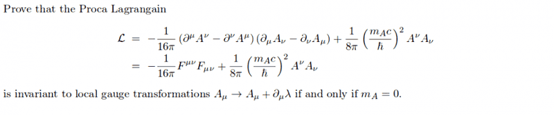

How do I properly use Ricci calculus in this example?
In summary, the conversation is about substituting A_\mu + \partial_\mu \lambda for A_\mu and also using a contravariant form of the substitution for A^\mu. The speaker is new to Ricci calculus and is seeking an explanation for raised and lowered indices. They have found online explanations to be unnecessarily complicated and have attempted a proof for Proca Lagrangian local gauge invariance. They provide a link for anyone with the same issue in the future.
jdbbou

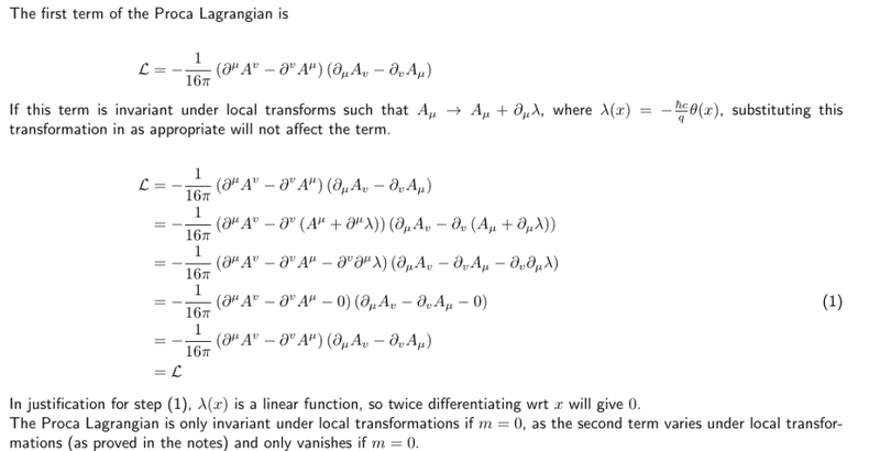

Do I substitute [itex]A_\mu + \partial_\mu \lambda[/itex] everywhere [itex]A_\mu[/itex] appears, then expand out? Do I substitute a contravariant form of the substitution for [itex]A^\mu[/itex] as well? (If so, do I use a metric to convert it first?)
I’m new to Ricci calculus; an explanation as to the meaning of raised and lowered indices here would be greatly appreciated. Everything I've found online so far has been (unnecessarily, I feel) complicated.
This is what I've tried so far. Any suggestions? Was my justification for step (1) correct?
