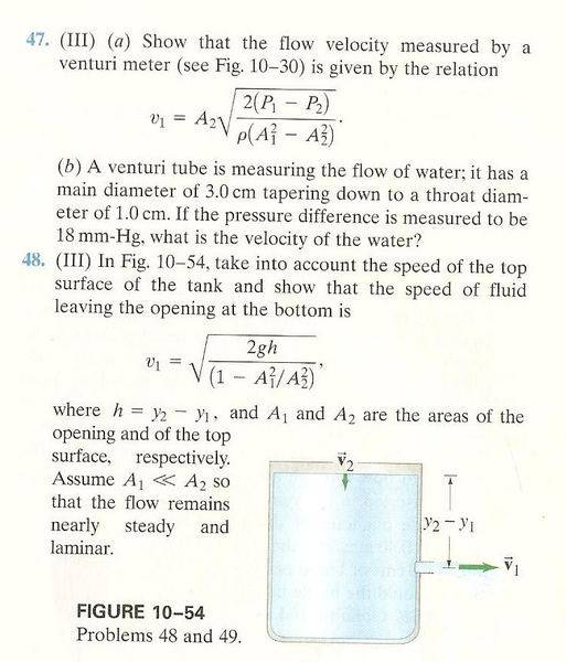

In summary, the student is looking for an equation that relates V1 and V2 in terms of the areas. By substituting V2 in for V1 in Bernoulli's equation, they find that V1 = V2 * A2 / A1. If they use P1 + 1/2 D V1^2 = P2 + 1/2 D (V1*A1 / A2) ^2, they find that V1 = Sqrt 2G(Y2-Y1) / (1-A1^2/A2^2).
Aliskahir
The problem is shown here, Problem # 48
I know that V1 = Sqrt of 2*G (h)
But the A1^2 / A2^2 part is unknown to me, and I've spent hours trying to find an explanation, but now I'm here...
Can anyone point me in the right direction, please?
Go back to Bernoulli's Principle. Find a relationship between V2 and V1 in terms of the areas. Substitute for V2 in Bernoulli.
In Bernoulli's equation I found that
V1 = V2 * A2 / A1

Solve that for V2 in terms of V1 (since you're looking to replace V2 in Bernoulli's equation.
Can you write the equation for Bernoulli's principle for this case?
(Using D for Density)
If I replace V2 With the equation I get
1/2 DV1^2 + DGY1 = 1/2D (A1*V1/A2)^2 + DGY2

You're missing the potential energy term (D*g*h) on the left hand side. Remember, there's a height difference between the two locations. P1 and P2 are the ambient air pressure, which can be assumed equal at both locations, so they cancel. Solve for V1.
1/2 V1^2 (1-A1^2/A2^2) = G (Y2 - Y1)
Yeah, I added it up top
Is it... correct? or closer to being correct? :confused:
Can't you compare it with what is given in the problem statement?
