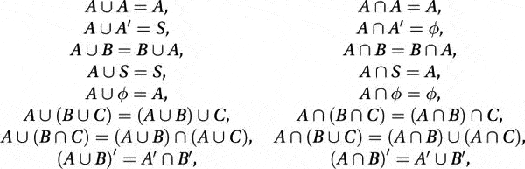

Okay, so I'm stuck at a step of a much bigger problem where I have to simplify a boolean function.
Here is where I'm stuck, I have to change the left hand side to the right hand side. How do I prove this with the rules of boolean algebra?
CA + CB + B'A = CB + B'A
The above is as far as I've gotten (as I said, this was taken from a bigger problem).
Can someone please show me the steps that will change the left hand side of the equation to the right? According to truth tables, they are infact equal.
