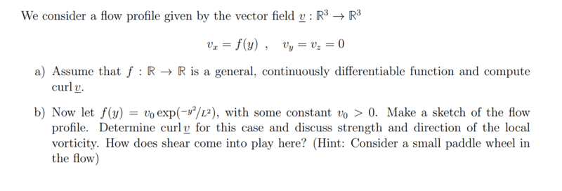

let f(y) = v0 exp(−y^2/L2), with some constant v0 > 0. Make a sketch of the flow
profile. Determine curl v for this case and discuss strength and direction of the local
vorticity. How does shear come into play here? (Hint: Consider a small paddle wheel in
the flow)

Hello,
Can someone explain how to sketch the flow profile in detail. Also, I solved for curl, but I'm getting a zero while the answer is the differentiation of the function f(y). Pls do help me out!

this is the entire question. I did (a).

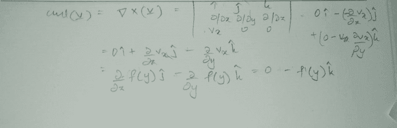

this is for part B, the one I'm doubtful of. The curl is f'(y), which I don't understand how. Let me know if I'm wrong anywhere.
Your attempt is OK but you feel uneasy, why?
Hey Gordianus,
This is the answer given by my professor and that is why I think my answer would be incorrect.
Also, I do not know how to do this linear mapping or sketch the flow profile.
