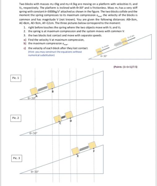

Two blocks with masses m1=3kg and m2=4.5kg are moving on a platform with velocities v1 and v2, respectively. The platform is inclined with θ=30ο and is frictionless. Mass m2 has a very stiff spring with constant k=3000kg/s2 attached as shown in the figure. The two blocks collide and the moment the spring compresses to its maximum compression xmax, the velocity of the blocks is common and has magnitude V (not known). You are given the following distances: AB=3cm, AC=8cm, AE=9cm, AF=12cm. The three pictures below correspond to the moment:
  1. right before touches the spring where the two objects move with v1 and v2 (This picture shows the blocks at positions A and B).
  2. the spring is at maximum compression and the system moves with common V (This picture shows the blocks at positions C and D).
  3. the two blocks lost contact and move with separate speeds (This picture shows the blocks at positions E and F).
a) Find the velocity V at maximum compression,
b) the maximum compression max,
c) the velocity of each block after they lost contact.(Hint: you may construct the equations without numerical substitution)

I cannot figure out how/whether the distances contribute to the problem since the blocks are moving up a slope. My professor allows us to answer the questions without substituting the numbers in.

Temple1998 said:
I used the Conservation of Momentum equation: m1v1 + m2v2 = (m1 + m2)V
What are the conditions necessary for conservation of momentum in a given direction in a given subsystem? Are those conditions satisfied for the subsystem consisting of the two blocks, in a direction parallel to the ramp, for the duration of the transition from state 1 to state 2?
Would gravity cause a net external force due to its x component? I don't know how to go about this problem if this is the case and I can't use the conservation of momentum equation. I just learned conservation of momentum and I haven't been able to find any other problems like this to reference.
Yes, and its contribution to momentum will depend on the elapsed time. Therefore you need to find the SHM equation describing the motion from state 1 to state 2 (unless you can think of a way of jumping straight to the oscillation period from the given constants).
Would it be incorrect to use the equation 1/2m1v1^2 + mgh1 + 1/2m2v2^2 +mgh2 = 1/2(m1 + m2)V'^2 +(m1 + m2)gh'? And I'm assuming I would use xsin30 for the heights? I don't have any experience with simple harmonic motion in relation to two objects.
You can certainly use conservation of energy, but you need to consider the energy change in the spring. I'm not sure whether that will give you enough equations, though.
I'm stumped at this point, then.
It can help to think in terms of the mass centre as far as possible, treating the oscillation as superimposed on the movement of that.
What will be the acceleration along the slope of the mass centre? What is its initial velocity?
Can you write an equation relating those to the given distances and to the time elapsed from state 1 to state 3?
Are v1 and v2 4ms-1 and 2ms-1 respectively - can't quite make out from the diagram of slope and blocks at the top ?
Since the influence of g is the same for both blocks, I am wondering if one can assume momentum conservation within the 'block frame' , solve the collision problem using standard methods, and then somehow translate the answers back to 'earth frame' ?
