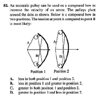

NA19 said:I need help with this attached question! The answer is supposedly B because of something to do with lever arms. But I don't get it at all!
NA19 said:Why isn't the pulley moving?
Why isn't the pivot in the middle?
A pulley can be thought of as a lever, at any given instant. A centrally mounted pulley isn't a very interesting lever because it's 1:1; the distance from fulcrum to contact point is the same for both ends of the contact. If the pulley is eccentrically mounted (and sufficiently frictional that the string does not slide) then it will behave like a lever, except that as the pulley turns the lever ratio will change.NA19 said:How do you determine that this is a lever question instead of a pulley question? I don't really understand how this system acts as a system of levers.
No. The pivot point is the dot, yes? In position 1, string B extent is closer to the dot where it reaches the pulley than is string extent A.NA19 said:Isn't B farther away from the pivot point than A in position 1?
Bottom pulley is the same, by symmetry. Only the pulleys separating extent A from extent B are relevant.Why are we ignoring everything but the top pulley.
