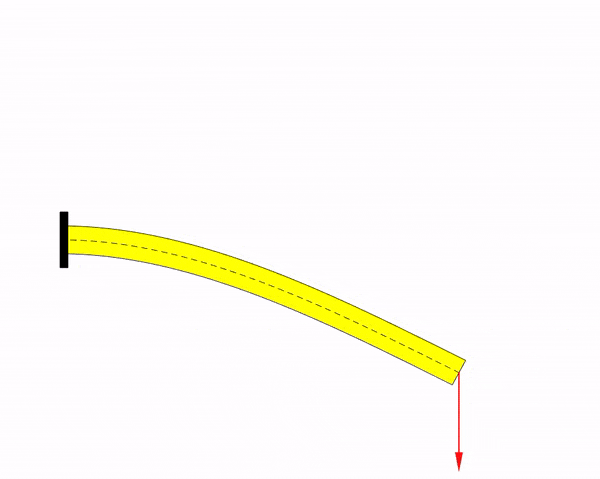

The free end of the spring acts exactly like the free end of a cantilever beam.
Vertical deformation is proportional to excerted force.
In the case of our bathroom scale, the deformation has been translated onto a graphic or display that shows how much mg is standing still on the platform.
If you jump a little, the rate of deflection will change some.
