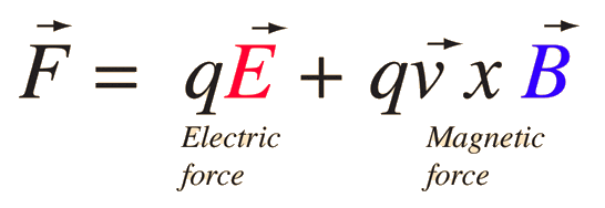

Also, it's helpful to know what density of a plasma you are talking about. At very low plasma densities, you may just be able to use the Lorentz Force for simple calculations (are you familiar with that equation?).
http://hyperphysics.phy-astr.gsu.edu/hbase/magnetic/imgmag/lorfor.gif

Thank you for the reply! I am a PhD candidate in Mechanical and Aerospace Engineering. I do have Chen’s book as it was the first place I turned to in attempting to answer this question (not a homework problem). I am familiar with the formula you proposed however, it is for single particles perturbed by an electric and/or magnetic field. I am more so trying to expand on the problem of what happens to plasma (as a collective group of ions, electrons, and heavy/neutral particles) at atmospheric pressure, with a high number density upwards of 10^21 persay in LTE or, based off Dalton’s law of partial pressures, having a degree of ionization of 10% let’s say as a sufficient yet arbitrary value.
My goal is to determine what is the best way to approach this problem, and if possible, an equation or system of equations which would allow me to determine the deflection angle of the plasma should it be deflected by an external steady state magnetic field.
