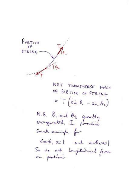

Suppose two equal and opposite gaussian pulses moving in opposite directions have their centres at the same point P on the rope at one instant. The displacement of the rope will be zero at the region of overlap (and everywhere else). But the (transverse) velocity of the rope will not be zero in the region of overlap. On either side of P the transverse velocities of the rope will be in opposite directions. You can convince yourself of this by drawing diagrams and thinking about which way the rope is moving as the pulses go though. Thus the waves can continue to propagate and will pass through each other unscathed, as the Principle of Superposition predicts.

If we had two equal but opposite propagating pulses on an elastic string that encounter each other, then at the instant where they completely cancel any and all transverse displacement then I don't see how can there be any enhancement of the local tension?
When you formulate the (linear) equations the tension force goes as the second derivative of the transverse displacement with respect to the string's equilibrium axis which would be zero. Furthermore on an intuitive level this seems wrong to me, if there is no deformation of the string then how can there be any sort of enhancement of tension at that instant?
After the temporary destructive interference, then the continued propagation of the pulse is more so to do with the waves energetics (tying in with Philip Woods discussion) than because of any localised tension.
Anyway, I am fairly sure of this so just wanted to (a) clarify that it is not tension for the OP or (b) have someone explain to me why I am wrong because if so I have some fundamental misunderstanding to iron-out. Cheers,

Well you are right. As Phillip Wood explains, consider two equal and opposite Gaussian pulses moving in opposite directions. At the moment when the pulses are perfectly superposed, the displacements will cancel completely and the string will be flat. But the transverse velocities are not zero even at the moment of cancellation.
Suppose for example you have a "positive" pulse traveling from left to right and a "negative" pulse traveling from right to left. Just before the moment of cancellation, the displacement left of center is positive going to zero and the displacement right of center is negative going to zero. Right after the moment of cancellation, the section to the left is continuing from zero to negative displacement and the section to the right is continuing from zero to positive. What this implies is that, even at the moment of cancellation, the string to the left has a negative transverse velocity and the string on the right has a positive transverse velocity.
So at the moment that the string is completely flat, the energy of the two waves is carried entirely in kinetic energy (just as with any oscillator crossing its equilibrium position).

Thanks for the reply mal4mac, but I don't think there is actually any tension the cartoon you describe, there might be a system of applied forces which sum to zero, but no tension arises (think of tension as an elastic property?).
Anyway, I think the key thing here is OP is asking why the waves don't collapse during the interaction, and why it is that they pass through each other? This has been answered by other posters (only the displacement cancells out, other properties are out of phase). I just wanted to clarify that if there is no transverse displacement, there is no tension perturbation/enhancement, so it isn't the relevant quantity that keeps the waves in motion after the interaction.
The standard first order theory of transverse waves on a stretched spring (that is the treatment that predicts linearity, and a wave speed independent of frequency, or, equivalently, of pulse shape) ASSUMES constant string tension. The propagation mechanism is by force components transverse to the string. These arise from the string not being straight. See thumbnail.
In the case we're considering, of equal and opposite pulses occupying, at one instant, the same portion of string, the string is instantaneously straight, but, as I tried to explain earlier, the string has transverse velocities. Another case where the string is instantaneously straight, but moving is when it has just been hit by a hammer. We know that even if the hammer is immediately withdrawn, the string will subsequently deform, and waves will propagate away from the point where the hammer hit the string.
