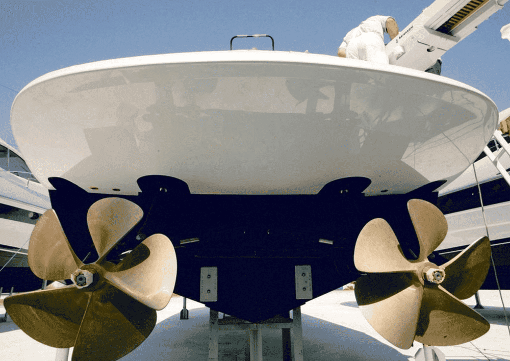

We have a new boat, and it has surface piercing propellers. Half of the prop is above (out of) the water, and half is below. I can't quite understand how that actually works or why it would be better.
I found this description online at:
http://forum.woodenboat.com/showthread.php?44600-Surface-piercing-props-question
The surface-piercing theory is based on the idea that the central portion of the prop--the hub, strut, shaft, etc., create mainly drag. In a high-speed boat, lifting this portion out of the water means that what is left---the tips of the prop, is 100% forward thrust. It's a nice match with a planing hull that likewise is mainly out of the water. In a low-speed application, such as a tugboat, the total blade area is more important for maximum thrust.

An alternative to the supercavitating propeller is the surface piercing, or ventilated propeller. These propellers are designed to intentionally leave the water and entrain atmospheric air to fill the void, which means that the resulting gas layer on the forward face of the propeller blade consists of air instead of water vapour. Less energy is thus used, and the surface-piercing propeller generally enjoys lower drag than the supercavitating principle. The surface-piercing propeller also has wedge-shaped blades, and propellers may be designed that can operate in both supercavitating and surface-piercing mode.

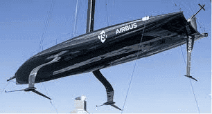

Is anybody following the Americas Cup race with those AC75 sailboats? Wow! How radical can you get.
Likes sophiecentaur
A.T. said:
I don't think they have to deal with caviation at the hydrofoils, do they? But I know the Sailrocket 2 had a caviating hydrofoil:
https://www.aerotrope.com/what-we-do/low-carbon-vehicles/sailrocket-speed-sailing.html
In normal circumstances that's correct. But in the accident shown in the picture, American Magic used too much rudder force in a sharp turn. That caused cavitation. The foils under the rudder lost lift, the boat angled up, became briefly airborne, and capsized. You can see the rudder in the 2nd picture.
I mentioned AC75 in this thread not because of a direct analogy, but as an example of a design change so radical that it's hard to imagine at first. That surface piercing prop is really radical.
Surface piercing propellers are only beneficial for very high velocities (Froude number well above 1, so planing boats). There is a limit to the amount of thrust loading (or power loading/power density, what's in the name...) you can put on a normal propeller before you get thrust breakdown. This simply means the propeller is only pushing water downstream, instead of also 'pulling' the water on the suction side of the propeller. For a normal propeller roughly 2/3rds is pulling, 1/3rd is pushing.
If you really need to go to higher power densities super cavitating propellers are usually the next step. The propeller, shaft and struts (holding the shaft in place) are still entirely submerged in this case. Here you simply accept that the suction side (forward facing side) of the propeller doesn't do anything useful and you are only pushing the water. Now you can design propeller blades which are better for super cavitation.
This is all well and good, but if you want to go to even higher power densities, the drag of anything in the water becomes enormous (and starts to cavitate and possibly erode and all that). So the beauty of super cavitating propellers is that there is only the flat surface of the hull and one blade of a propeller that is in contact with the water at any point in time at these very high speeds. The propeller shaft and anything else is all entirely above water to minimize drag, which is a real benefit at these high speeds. Secondly another advantage is (I think) that you are accelerating most of the water through the air, instead of generating a jet in the water. Just as for waterjets, this is beneficial for efficiency since the goal of both a waterjet and a surface piercing propeller is to generate as high as possible water velocities (look at the trail of water above the water surface aft of a surface piercing propeller at high speeds).
But please note the following simple physics: momentum (or thrust) is mass(flux) times velocity. If you double the mass, you double the thrust. And if you double the velocity you also double the thrust. However kinetic energy is mass(flux) times velocity squared. Thus doubling the velocity takes four times as much energy! This is why it is always better for efficiency to accelerate a lot of water a little-bit instead of a little-bit of water a lot. So increasing the water velocity is never a very efficient option. At these speeds you have no choice however.

Surface piercing props are really interesting - as mentioned above, they're mostly a thing when you're trying to push a very high amount of power through a relatively small propeller. Normally, that's limited by cavitation on the suction side of the prop, which can be damaging. However, a surface piercing prop entrains enough air to maintain a constant air cavity on the suction side, entirely preventing cavitation. This also means that you effectively have a reduction in prop area as the boat speeds up, which is beneficial for the top speed/acceleration tradeoff (a large prop is good for acceleration, a smaller one can give a higher top speed, so long as you don't run into cavitation or breakdown issues).
Preventing cavitation is not the main benefit for surface piercing propellers. Supercavitating propellers cavitate a lot but that is fine as long as there is no erosion. There is no erosion because the cavity implodes downstream of the propeller blade (because 'super' in supercavitation means the cavity is larger than the blade). There is however a velocity at which the cavity does end on the blade, however you don't buy these kind of boats to sail at such a low velocity ;).
