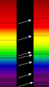

Well, all you need to do is calculate redshift before calculating temperature.
But how do you do it? If the object is traveling uniformly with respect to us, then we wouldn't know if it is actual spectrum or the redshifted spectrum.
What you do, is you look at the stellar spectrum and identify the characteristic absorption lines. A stationary element(e.g., a hydrogen atom) always produces the same set of spectral lines associated with the discrete energy levels of its electrons.
By comparing the lines to lines produced by atoms in laboratory, you can find out the redshift.

As Bandersnatch said, we use emission and absorption lines of known elements to calculate the amount of redshift or blueshift an object has. Then we can correct for it and calculate the correct temperature.
Suppose we have redshifted spectra of hydrogen. Then, can't we say that the star contains some material which emits light similar to hydrogen but slightly at the red end?
There is no such material. Astronomers don't look at just one spectral line; one line by itself supplies no information. Several lines do supply information. There is no substance that mimics the spectra of hydrogen.

Spectral lines are unique to every element. They are like fingerprints. No two elements are the same. It's important to understand that we know why and how these lines are created, so we are certain that there is no material that will emit that specific pattern of lines other than one specific element.
