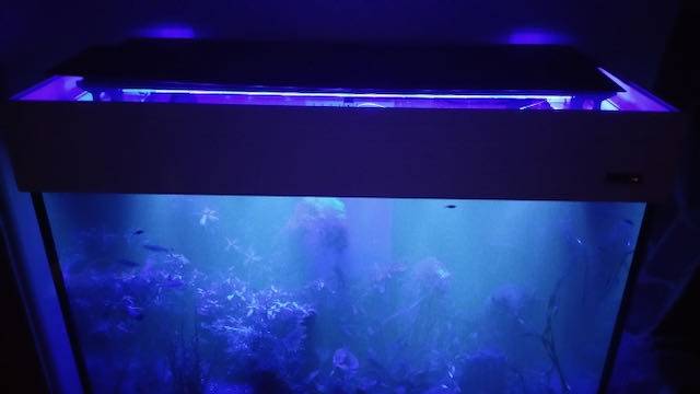

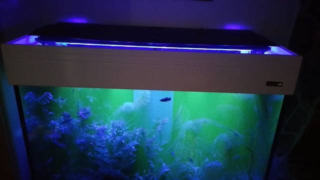

I am an engineer, and I own an aquarium, at least I owned an aquarium with an awesome LED light.
Under certain conditions, I found that when the blue night light was on, organics in the water would fluoresce, green, and penetration would be reduced.
How do we know that a similar phenomena, not necessarily organic has not occurred to light from the far field. Flouresence, filtration, or some other action on light of shorter wavelengths?

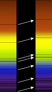

If you look at the Wikipedia page on Redshift you will see this picture
The spectral features move. Filters don't do this. Neither does fluorescence.
