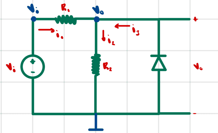

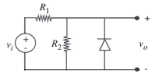

Assuming the diode can be modeled as an ideal diode, and ##R_1=R_2##, plot the waveform ##v_0(t)## for the circuit below assuming a triangle wave input.
Write an expression for ##v_0(t)## in terms of ##v_i, R_1##, and ##R_2##.
This problem is from Agarwal's Foundations of Analog and Digital Circuits.
Here is the circuit.
Here is my own picture of the circuit with circuit variables
If ##v_0<0## then we replace the diode with a short circuit and
$$v_i=i_1R_1$$
$$i_3=-i_1$$
$$v_0=0$$
If ##v_0\geq 0## then we replace the diode with an open circuit and
$$v_i=i_1R_1+i_1R_2=2Ri_1$$
$$i_1=i_2$$
$$v_0=i_1R_2=v_i\frac{R_2}{R_1}$$
At this point we would sub in an expression representing the triangle wave that is ##v_i##.
I'm not sure exactly how this would be in this context. I have used a periodic triangle wave function defined as ##f(t)=|t|## on ##t\in [-\pi, \pi)## which I then expressed as a Fourier series.
For the purposes of this problem, how would I represent the triangle wave?
Hi,
Check your ##v_0=i_1R_2=v_i\frac{R_2}{R_1}##
##f(t)=|t|## is a triangle wave plus a constant voltage. That's not what the exercise composer intended.
You are right, I missed a factor of 2 in the denominator of the expression for ##v_0##. Here is the correction
$$v_0=i_1R_2=v_i\frac{R}{2R}=\frac{v_i}{2}$$
##f(t)=|t|## is indeed always positive but making this symmetric about the ##x##-axis is just a question of offsetting by a constant, right?
In any case, it does not seem that the assumption about what exactly the functional form of the input voltage ##v_i## is is relevant to this problem.
We could sub in many different functional forms. It's just a substitution. Or maybe I am missing something?
