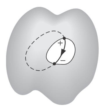

It is possible to show via Gauss' law that the the net flux through a surface within the Faraday cage must be zero, however this is not a sufficient condition for the electric field to be zero. For the electric field to be zero in the interior of the cage, all points within the cage must be at equal electric potential; I suspect showing this constitutes the other half of the proof.
Griffiths proves it another way (please see the diagram below!); if we suppose electric field lines do exist within the cavity, then the voltage change around a closed loop the rest of which is inside the conductor is non-zero, which must be wrong (i.e. KVL). So there can be zero E field in the cavity.
However, I wondered whether it is also possible to prove it the first way through consideration of the potential in the cavity; are there any theorems which might help to do this?
I came across Laplace's equation, which in one dimension ##\frac{d^2 V}{dx^2} = 0## permits a linear potential and consequently a constant electric field, though this doesn't seem to add anything else to the original statement of Gauss' law.

Let’s assume that ##\mathbf E## does exist inside the cavity (when cavity is free from charge). This means that field lines must start at some point on the boundary of cavity and end at some other point on the boundary of the cavity (Griffiths figure) because field cannot exist inside the conductor.
For any Gaussian surface we will have $$\oint \mathbf E \cdot d \mathbf a = 0 \\
\int_V \left (
\nabla \cdot \mathbf E \right) dV = 0 $$
Since, this is true for any volume ##V## therefore we have ## \nabla \cdot \mathbf E =0##. This contradicts the fact field lines must come out and sinks down . (Because electric field have zero curl and hence cannot form closed loops). Therefore, electric doesn’t exist inside the cavity.

But doesn't this just mean the net flux per unit volume is zero? That is, we could still have a uniform electric field within the cavity, with the field lines originating and terminating at points on the cavity boundary, and have ##\nabla \cdot \vec{E} = 0## for a surface within the cavity.
The argument Griffiths proposed about considering a closed loop seems good to me, however I'm not sure if we can derive it just from a statement of Gauss' Law.

Thanks for your reply @Adesh! I think your argument is correct, so long as the possible Gaussian surface can extend into and outside of the conducting material.
For instance, we might imagine a surface which encloses half of the cavity, half of the conductor and a bit of the outside space. Indeed, if an electric field were to exist, the net flux would be non-zero whilst the enclosed charge would be zero and that gives rise to a contradiction.

In addition you also know that in the static case ##\mathrm{curl} \vec{E}=0## too. Helmhotz's fundamental theorem of vector calculus thus tells you that ##\vec{E}=0## within the cavity.
