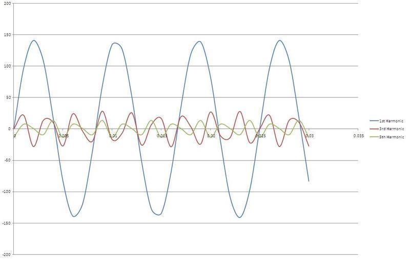

should it look something like this?
You're sketch for fifth harmonic should show x5 the frequency!

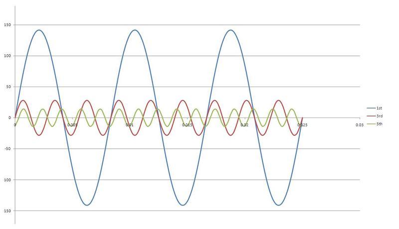

Ok so i have changed the time scale and got this...
does this look as it should?
That looks more like it. :smile:

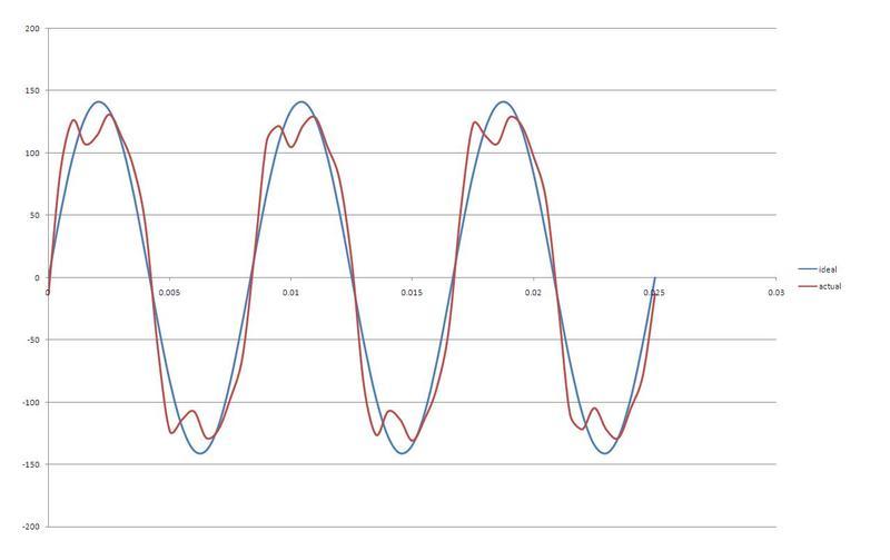

i have ploted a graph to show actual Vs. Ideal

Oxon88 was the sketch of the waveforms for the harmonic components correct?? I have values for them all but not sure how to construct the sketch as I am unsure of the time intervals to use for the different waveforms.
Yes it was correct. I can't remember what time intervals i used. I can have a look for the spreadsheet and check later for you.
Perfect Ill try and work it all out now from your images in the meantime
NascentOxygen or Oxon88 how to do you calculate the various different values for your graph? I can't quite get my head round that part and would be very grateful of a little help with understanding it please...
