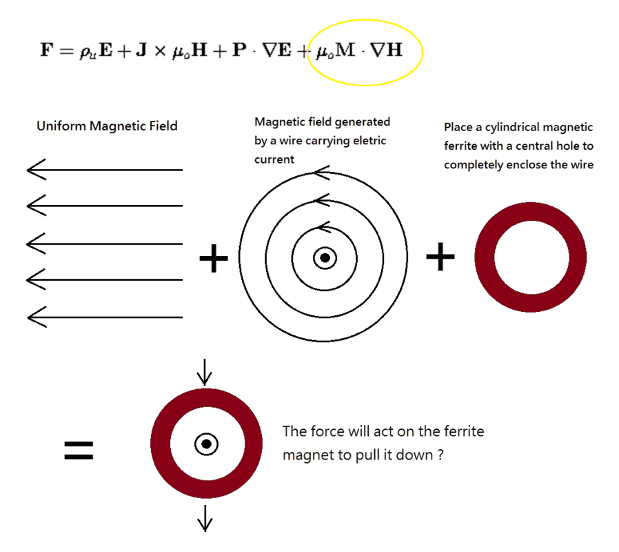

Ferrite material (high permeability, low magnetizability) comes in various shapes. I am using a cylinder about 3/4" dia x 1.5" long with a 1/4" hole through it, and the wire mentioned goes through the hole.. The cylinder seems to shield the wire completely from the constant field originally present. So there is no force on the wire, but instead a force on the ferrite.
Do you have data...like before and after introducing ferrite ?
Yes, I've run this experiment many times, with various sized cylinders, different "uniform" magnetic field sources, and different DC currents in the wire. The results have been as described. Before introducing the ferrite I measure the field. With the ferrite in place I measure the force on the ferrite with increases in current.
Let me share some details. Direction of magnetization of ferrite and direction of original uniform magnetic field coincide ? Direction (and magnitude also?) of force on ferrite and force on wire in original setting coincide ?
Please describe how you supply the "uniform" external field of that size? (2"x2"x1" is pretty large for a strong uniform field.) A piece of ferrite will experience only torque in a uniform static magnetic field.
I create a "uniform" magnetic field over a small volume with two 4 x 6 x 1 inch magnets. I have used other somewhat smaller sizes also. Over the volume of interest the field is approximately 50 gauss plus or minus about 2 to 4 gauss.
When I mathematically subtract the original uniform field from the total (vector) field the result is a varying field that is close to what you would expect from the ferrite itself if it were an isolated magnet.
The force direction on the ferrite coincides with what theory predicts for the wire itself. The magnitude of the original force on the wire cannot be measured very well, but the magnitude of the force on the ferrite is approximately what is expected by the Lorentz equation for the length of wire inside the ferrite.
While I do not doubt your measurements, the experimental conditions are far from ideal, and your explanation does not conform with any known electromagnetic theory. Ferrites do not "shield" DC fields and any piece of ferromagnetic material will feel a force only if there is a gradient in the local field.
You may wish to change your analysis considering those factors.
I agree the experimental conditions are far from ideal, but the results I describe have been repeated with numerous set ups and instruments, and with a lot of checking for errors. A ferrite cylinder with a hole through it lengthwise, placed perpendicular to a uniform field, shows 0 field inside the hole, measured with several lab quality gaussmeters.
I do not have an analysis of these results; I'm just reporting my measurements. I was hoping there might be an analytical treatment out there somewhere I was unaware of.

Yes, there is no force on the ferrite when the current is zero. The ferrite is just in a uniform field. I agree the circular magnetic field from the wire in the current must be at least partially responsible for the forces we see on the ferrite. But deriving a quantitative relationship to explain the force is more elusive.
Oh I see it: The total magnetic field in the presence of the current carrying wire is no longer uniform. The polarizable material (ferrite) will be drawn towards the region of higher field density which will be in the appropriate (Lorenz force) direction. Nice.
I agree that the magnetostatic problem you raised is quite complicated and difficult to obtain a complete analytical solution. Sometimes, in order to obtain accurate results, numerical solutions are inevitable.
However, I believe we can still try to reason about an abstract result of this situation based on the Lorentz force and the Biot-Savart Law.
Firstly , in an uniform magnetic field, in presence of a wire carrying electric current, and also certain ferromagnetic material, the directions of magnetic moments inside the ferromagnetic material will be redistributed in accordance to resultant effect of two magnetic fields, one is the uniform magnetic field, the other is the magnetic field generated by the wire carrying electric current.
Secondly, there will be certain magnetization current distribution appear as a result of the said redistribution of magnetic moments inside the ferromagnetic material.
Therefore, if I am not mistaken, by Lorentz force law, the force acting on that ferromagnetic material should be equal to the force acting on magnetization current inside ferromagnetic material by the total magnetic field in the space🤔.
Again, if I make the wrong reasoning, I apologize.

I agree, this is a messy enough scenario that I suspect a numerical approach will be required. Also, @Keasy will need to use the macroscopic equations given in 11.10.19 here: http://web.mit.edu/6.013_book/www/book.html
Likes alan123hk and berkeman
Thank you for providing the link to the macroscopic equation in Section 11.10.19.
I think the equation can explain why the force acts on the ferrite magnet, as described in OP #1
Since an analytical solution may require a lot of mathematical work and simulation software, I am trying to infer abstract results based on the macroscopic equation by imagination.
