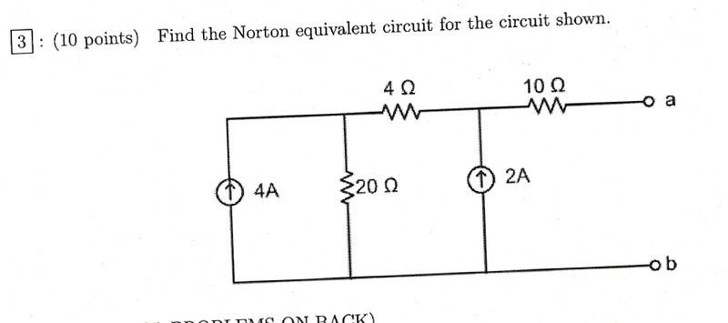

Find norton equivalent circuit
Rn=Rth
Ok i got my R(n)=34 ohms because after you turn off independent sources the resistors are in series, then I short circuited a to be and I'm trying to use mesh analysis to solve for I(n)
the problem arises with the 2 amp current source does that make I2 and I3 2 amps? help!?
