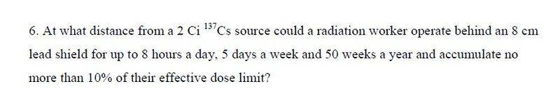

I have attached a picture of the question.
A 2 Ci 137Cs source is equal to 2 x (3.7x1010 Bq) = 7.4x1010 s-1
8 hours a day, 5 days a week and for 50 weeks is a total duration in seconds of 7.2x106 s
An 8 cm lead shield = 0.08 m
IRR99 regulations set an effective dose limit as 20 millisieverts per year. Therefore, 10% of of their effective dose limit is 2 millisieverts = 0.02 m2s-2
None
[7.4x1010 s-1 x 0.08 m] / 7.2x106 s = 0.02 m2s-2 - d
d = 2.4x10-5 m
I jiggle the equation about in different ways but keep getting small values for d.

You need to find the the specific gamma rate constant/dose rate constant which relates the dose rate (Sv/hr) at a specified distance to the activity(Bq) of the source which a published for radionuclides and sources made from them.

I have a dose constant of 0.38148 Rem/hr for 137Cs at a distance of 1m from a 1 point curie source.
Hi,
A small, help,
For Cs137 you have the specific dose rate 84 microSv/h/GBq at one meter
For 2 Ci it gives 6216 microSv/h
Your worker works 2000 h and your objective is 2mSv per year so your objective dose rate is 1 microSv/h
The attenuation coefficient is for lead and 660 keV 1.4 /cm
With that you must conclude
I have 30 cm

Yes, first you use the exponential to find how much radiation makes it through the door, then you use the inverse square law to find how much distance you need to put between the worker and the door to get the desired overall attenuation factor. Look at post #8 for the linear attenuation coefficient for lead.
I = I0e(-ux)
I = (7.4x10-10)e(-1.4x0.08)
I = 6.61x10-10 s-1
I = 1.83x10-13 /hr
I = S/4 pie r2
r = square root [(10-6)/(4pie)(1.83x10-13)]
r = 659

The attenuation coefficient is in 1.4 cm-1 so the door thickness should be expressed in centimeters not meters. This should change your answer significantly.
Using the thickness in cm does change the answer but it's still wrong by a lot. Thanks for the help.
I need someone to type out the solution as it's the only way I can understand this question. I don't know what I'm doing and have wasted too much time on this one question.
Using the following data
dose at occupied area = 2 mSv
attenuation coefficient for lead and Cs-137 gamma rays = 1.24 cm ( gives a Half Value Layer of 0.56 cm the published value)
shielding 8 cm lead.giving an attenuation of 0.492 x10-4
Dose rate constant = 0.003815 Sv/Ci/hr at 1 meter
time of occupation = 2000 hrs
Source activity = 2 Ci
I get 61.3 cm

adamworth said:
How do I take a reading for a value of u (in cm) for 662 kev from this data?
First you need to convert 662 keV to MeV in the format 6.62×10y MeV. (What should y be?). Then you find the closest value in the Table and interpolate.
Be sure to read how to use the value that you found here.
https://physics.nist.gov/PhysRefData/XrayMassCoef/chap2.html
For 6.62x10-1 the closest value is 6.00000E-01, which gives a reading of 1.248E-01 for u/p. Not sure what to do now.
Right so 6.00000E-01 cm2g-1 x 11.34 gcm-3 gives ~ 1.4 cm-1 for u. When I put all of this into my formula I get 28.98cm which is apporoximately 30cm. I'm satisfied that this is the correct answer unless anyone thinks my value of u is incorrect?
