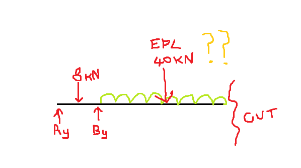

Afreiden, I tried cutting the beam into the sections as you suggested, when considering the far left 6' beam, I made the four meters of distributed load into a point load of 40kN at 2m from point B. I summed the moments about point B and found that Ay = -36kN (pulling down). This answer is different to the one generated on the program which states that Ay is -66kN.
*please see my paint drawing attached
Also, I am confused with what to do with the load at the second hinge where I am cutting (this load is 10kN).
Thanks for all your help!

There's no moment at the cut, but there is a shear - that you've neglected.
I recommend you draw all three segments with all forces (known and unknown) before proceeding.

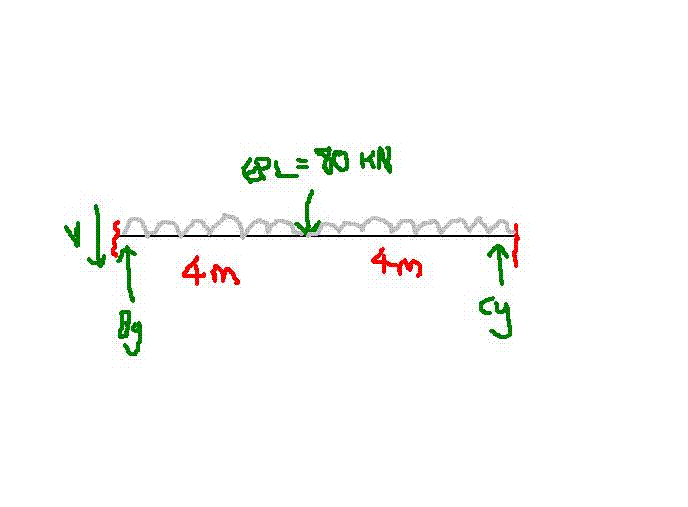

I did as you said, taking the center section between the two pins, and summing the momments abouty the left end and found Cy to equal 40kN (not 35 which is the correct answer, I've attached a paint drawing of the section, do I need to include a shear force at the right hand end, if so how do I obtain this force?

In the absence of further help from the Science Advisor, I can confirm that your set of reactions is correct.
However your paint sketch is incorrect. You have not followed the advice from afreiden or AZ.
How did you calculate the end reaction RD as zero?
Draw the beam and since you have labelled the supports A, B, C, D, label the left hinge E and the right hinge F.
Call the reactions RA, RB, RC, RD
and the hinge shears VE, and VF
That makes 6 unknowns as afreiden says. However you can easily establish that RD =0 How?
So that leaves 5.
By careful choice of equations on the three free bodies suggested by afreiden you do not have to calculate the hinge shears.
Now what is the standard method for excluding a force from an equation?
Hint take a moment about its point or line of action.
So what equations can you come up with?
Further hint, if you have a copy of Marshal & Nelson have a look at pages 41 to 43.
