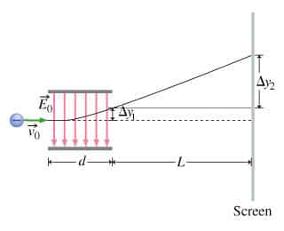

What is the distance Δy between the two points that you observe? Assume that the plates have length d, and use e and m for the charge and the mass of the electrons, respectively.
Express your answer in terms of e, m, d, v0, L, and E0.
kinematics equations
F=qE=ma
Split the problem into 2 sections, the first being with acceleration due to the electric field,
t1 = when particle lease electric field
t2 = when particle hits screen
so at t1 a distance d
d = v0t
Δy1 = ½at2
t values are unknown so I eliminate t
t=d/v0
and
qE0=ma
q=e
(eE0)/m = a
Δy1 = ½((eE0)/m) (d/v0)2
now for the x and y components of velocity at this point
using the equation
v=v0+at
vy = 0 + ((eE0)/m)(d/v0
vx has not changed so = v0
Now is have the height at d and both components of velocity, I can use kinematics to find the particles motion from d to L using these values (at d) as the initial points.
Δy2 = Δy1 + vy(t)
this t value will be
L= v0 t
t= L/v0
plugging it all in
= ½((eE0)/m) (d/v0)2 +
(eE0/m)d/v0*L/v0
This is not the correct answer for Δy2
once I know Δy2 I can find Δy = Δy2 + Δy1
But I can not find my mistake in finding Δy2

In your diagram, the distance Δy2 does not include the distance Δy1.
But your equation Δy2 = Δy1 + vy(t) contains Δy1 on the right hand side.

@TSny is making the observation that your use of variables has strayed from the definitions in the figure. In the figure (and the problem statement) the total displacement is given by ##Δy = Δy_1 + Δy_2##. You have essentially redefined ##Δy_2## to be the total displacement.
Likes David112234
Ah now I see what you mean, Δy2 is not measured with re
respect to the zero line (whereΔy_1 was), my equation than should be
##Δy = ##Δy_1 +v(t)
So how would I find Δy_2 before finding ΔY?
Consider the "launch" conditions from the Δy1 location and use geometry (and similar triangles in particular).
You should have both the x and y velocities of the electron at the Δy1 location.
Likes David112234

This would be correct if you replace the v(t) expression by the expression you wrote in your first post vy(t). I assume that by vy(t) you meant vy⋅t.
Likes David112234
Yes, because the only effect the x velocity is making it hit the plate before it can reach any higher.
Yes. In your first post you have the correct expressions for vy and t to use for Δy2 = vy⋅t.
