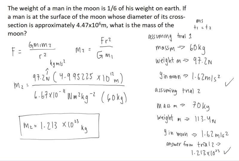

The weight of a man on the moon is 1/6 of his weight on Earth. If a man is at the surface of the moon whose diameter of its cross-section is approximately 4.47x10^6, what is the mass of the moon?
F=gm1m2/r^2
Thanks for the help! :)
Edit: My answer is 1.25 x 10^7 ( I do not think it is correct, I'll try to think some more and update my answer)
Do we need to get the mass of the man? or is this problem actually solvable?
-sun1108

I tried doing it again this time I got 1.213 X 10^23 kg
Working: m2= Fr^2/Gm1
Assuming mass is 60kg weight in moon will be 97.2 N
So m2= 97.2N(4.985225 x 10^12m)/6.67 x 10^-11 Nm^2kg^-2(60kg)
m2= 1.213 x 10^23kg

When I search online, the mass of the Moon is given as ##7.35 \times 10^{22} kg##.
PS that said, the diameter of the Moon is given as ##3.5 \times 10^6 m##.
Using the data you were given, your answer is approximately correct. If I use ##g = 9.81 m/s^2## for Earth, I get ##M = 1.25 \times 10^{23}kg##

So sorry for the very late reply, I haven't been opening my account, thank you so much for your feedback.
I apologize for the very late update: I tried doing the question again later, but then I still arrived at the same answer. Here is my working.
I just put the numbers in a spreadsheet:
GDRgM
6.67E-11​
4.47E+06​
2.24E+06​
1.635​
1.22E+23​
The first column is the gravitational constant. The second is the given diameter of the Moon. The third is the radius of the Moon (##R = D/2##). The fourth is the Moon's surface gravity, which I calculated as ##\frac{ 9.81}{6} \ m/s^2##.
The final column, the estimated mass of the Moon, I calculated using the formula for surface gravity ##g = \frac{GM}{R^2}##.

Yeyy, so my answer is correct :). Thank you so much for your help and prompt reply, I truly appreciate it :)
